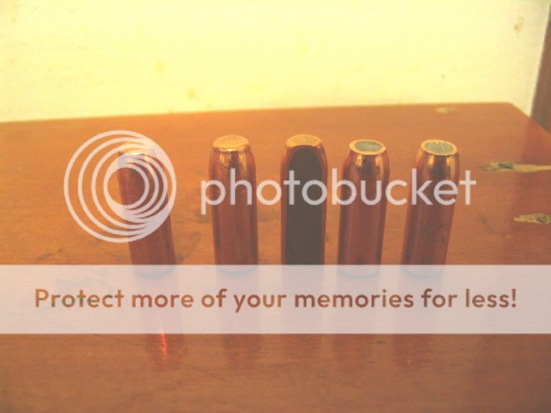

I sectioned one bullet, and I took a few (30-40) swipes at one with a bastard file, did the same to one with the belt sander.
I have the unique opportunity that the F&W officers are using our range this week for qualifying, so getting a good cross section of opinions as to the legalities of said bullets in the un touched form will be possible.
As you can see in the picture these bullets are not copper washed, the thickness of the copper at the bullet tip is approx. 0.025".
Range test of 2 un touched and the two filed/ ground bullets to follow.
Great pics - thanks. Yea, I think that qualifies as FMJ (CMJ actually). Their purpose seems dubious: not a solid, and not in a chambering typically recommended for dangerous game; not a target profile and not much demand for 0.311" target bullets anyways; and not a great hunting bullet IMO, even if they were legal.
I'd like to see what happens when they hit wetted newspaper or gelatin, both as is, and modified as you have done - which I don't recommend for reasons of consistency (and hence accuracy) and concerns over jacket separation (albeit small, as the base is enclosed).
Most interesting. I'd had these sitting around for some time and hadn't really bothered with them. If I ever get some spare time I should load some up myself and get to the range with a box of wet newspaper.
Andy's comment seems appropriate, at least for this calibre. Frontier claim "straight-line penetration" and of course if they don't expand, that would be quite likely.
I can see that, in the medium and big calibres, such as the .375 and .458, the wide meplat, plus a tough jacket, might be useful- sort of a "semi-soft." It wil be interesting to see the results when shot into a suitable medium. My guess is that they will expand, but very little.

Here's the straight goods from 15 or so Fish Cops as to what they would call the frontier .303 bullets. Unanimous Non Expanding (Alberta). They said that with the misconceptions as discussed (never mentioned CGN) they will certainly be watching for non expanding ammo a lot closer than the usually do.
Range test is waiting on Ma Nature to smartin up.
I never took the "filed bullets" I simply showed them the un touched one I had left and the sectioned bullet.
The discussion as I took it was whether the un touched bullets were considered expanding or NOT.
The filed bullets would without question be considered of the expanding variety, but their performance as a game bullet is another thing yet to be evaluated.
