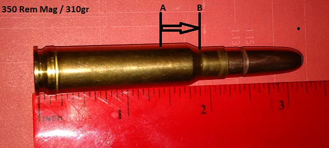

But lacks the efficiency of my 350 RM which will drive a 250gr bullet at 2800 fps with nearly the same amount of Re17 you are using and without compression. A sharper case shoulder coupled with shallow seating depth, generous throat length and a longer barrel will do that.
My barrel has a 1:12" twist which works against higher muzzle speed compared to a slower twist barrel because of increased friction. I specified a 1:12" twist in order to stabilize the 310gr bullet.

However, the lighter bullet loads aren't of primary interest. It's the near maximum 310gr load at 2465 fps MV.
Possible with a long drop tube funnel kit, an MTM product. A bit of tapping on the case side helps too. With 200gr TSX bullets I safely got 3050 fps MV with a bit more powder. Fun and games.

But I am sceptical of the claim of getting more energy (velocity) due to cartridge design (short/fat/sharp shoulders). The increased velocity comes from increasing the case capacity by seating the bullet shallower, and of course the longer barrel. It's not "more efficient" than a 35 Whelan if you compare apples to apples. We all heard the claims of magic when the 300 WSM was new - more velocity for less propellant but they were all thoroughly debunked.
