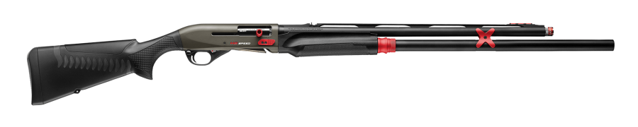

The new speed has an enlarged loading port, folding rear sight, comfortech 3 stock, lightened and coated bolt. I’m sure I’m forgetting something but those are the main things
What is different between the newer “speed” and the older “speed performance”?
I’m in the market for one but no rush.
Thanks!
Everything mentioned by Sudbury Shooter, plus the geometry of both the receiver and the bolt release. I've not seen the Canadian exclusive one (no word yet from our suppliers), but the Benelli M2 Speed also appears to have a red magazine tube as opposed to the regular black one we've seen thus far.

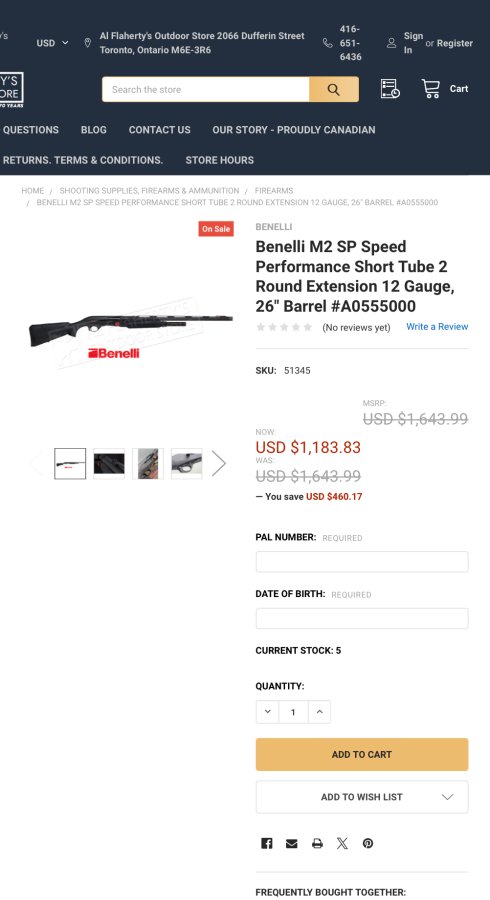

I bought one locally for $200 more then that this weekend!!!!
