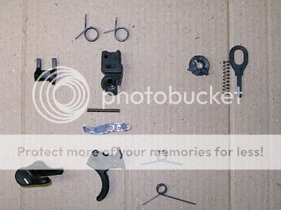

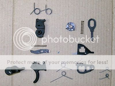

From what I have seen in the armorers manual, my SL8 trigger and a spare G36 (S,F) trigger that I have this is what I have found. Please remember I am not a gunsmith.
The SL8 safety blocks the trigger and the slide. The G36 (S,F) safety only blocks the trigger. All the other G36 safeties that have a slide still only block the trigger. The slide in the G36 SEF and burst packs is used only for disengaging the sear. In the pictures below you will see a tab on the bottom of the SL8 slide, this is what blocks the sear. The G36 slide in the SEF and burst packs is flat in that section.

SL8
G36 (S,F)
