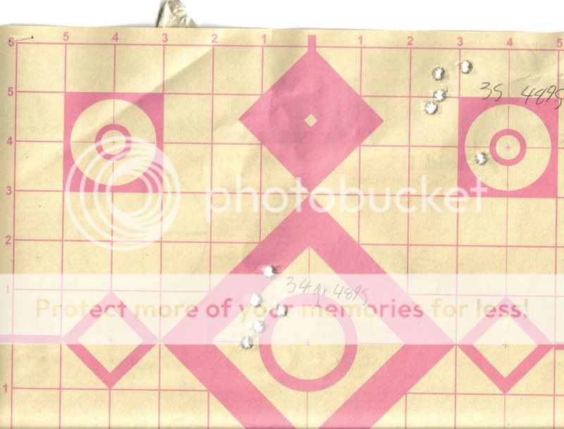

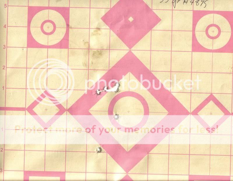

Here's the 100 yard groups:
33 Grains:
34 Grains centre group, 35 grains in the upper right:
So, nothing too stellar, but not too bad either, considering consistency might be tricky with a case that's only half-full. I'm guessing the fliers are just a matter of inconsistent ignition resulting from the fairly empty case. That kind of accuracy is fine for me for 100 yard plinking.
33 Grains:
