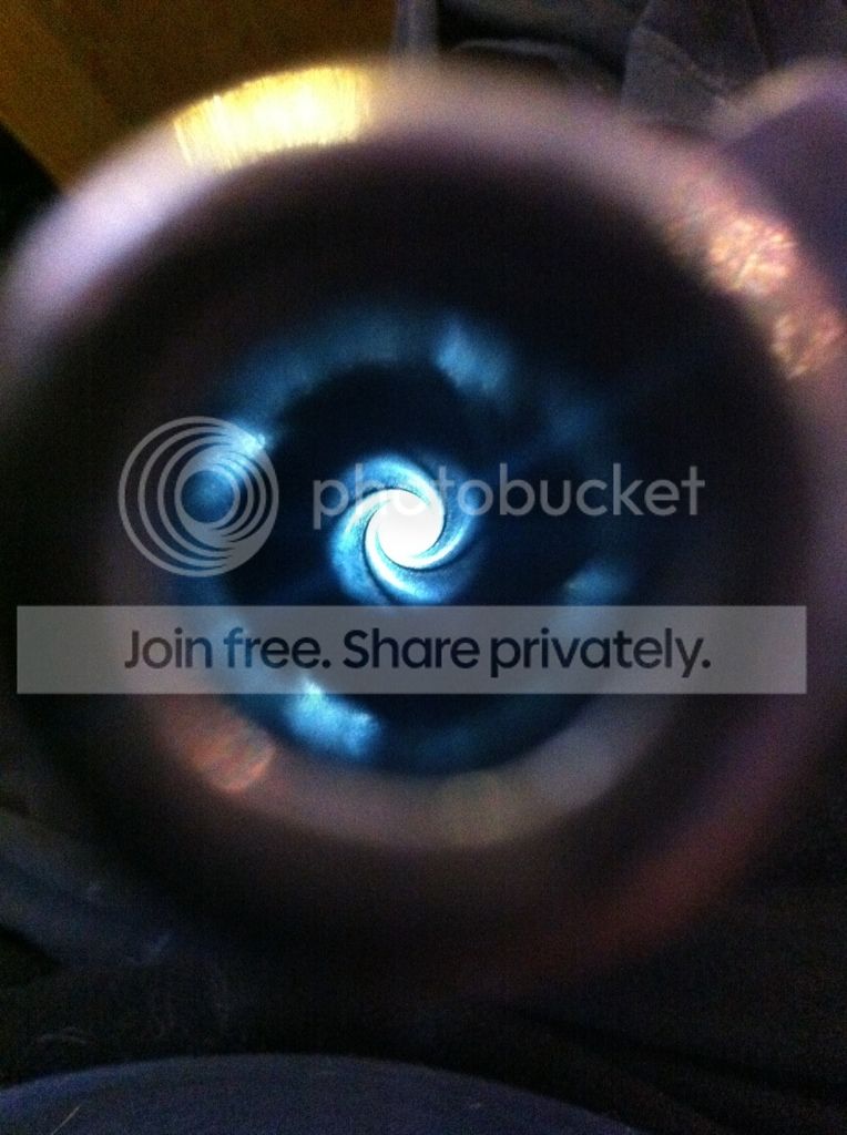

I have a turk mauser in 8mm that shot very similar to the one in question when I first got it. 4 feet high at 50 yards, didn't group too bad 3-4". I bought it very early on in my shooting career bore was very ratty so after scrubbing it lots I decided to shoot it. After 30 or 40 rounds i discovered this in the bore here's a picture notice the ring??
I just recently counterbored it and now it now shoots 6" hight at 100 yards.
My question is is the barrel bent or can you see a ring in it???
I've worked on 3 rifles thst had a similar problem to the one in question 2 had a slight curve to the barrel and the 3rd is the one I posted pics of. Check the barrel carefully, it may be a Longshot but never hurts to look.
