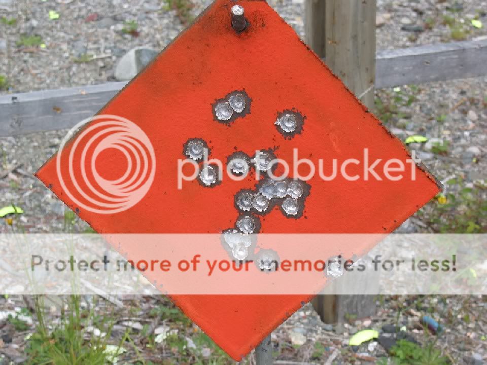

I will make it a 9" circle. I will hang it from a stand of some sorts, bent rebar or some flat bar I have, allow it to swing a bit. Some one said 1/2" mild steel is sufficient, but I would think that it would ventilate easily.....??!!??

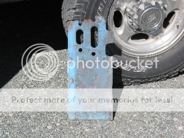

This is a wear plate off a dozer blade. Good for any cal. At 200 yards.

I use old John Deere disk blades work like a charm and cheap. I've also cut down rub bars from a combine to 24" tall and welded 6 together and that seems to work very well doesn't last as long as the disk blade though!

made a gong of cold roll 3/8 '' steel 18'' round and shot it at 300m with .338 win mag and needless to say punched clean hole after hole. Oh well its only time and money. The only thing I have seen stand up is oil field pipe caps that is about inch to inch and one half thick.
