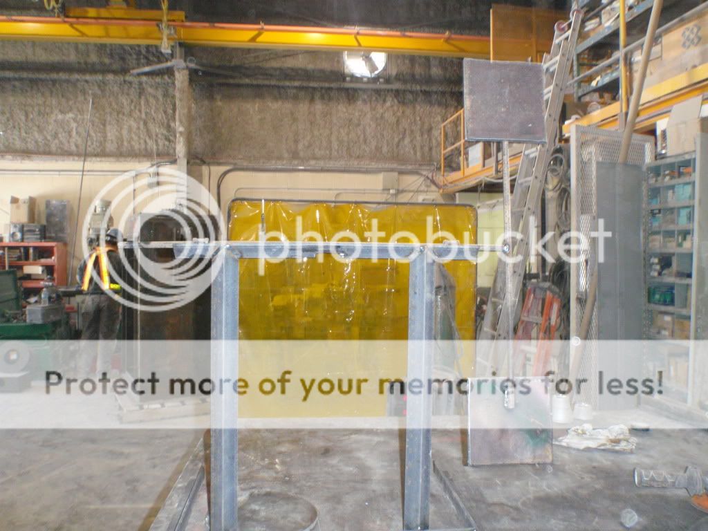

I made up this paddle wheel out of AR plate(not sure which type) 308 would go through at 100 but not two hundred.
