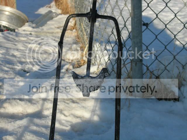

Here is one of the one I made.....
I thought an old 12" cast iron frying pan would make a good cowboy action target so, I rigged one up to a hinge by the handle so it would swing back and forth and hung it between the gate posts. Since I'm using lead bullets in .38 spl cases with CAS loads I though it would just go ding. Instead, the first shot from my Chappy "66 from 60 yds left a hole the size of a Loonie and the second shot was the size of a Toonie. So much for that idea.
I tried steel plate - 5/16 - welded a small L bracket from the top of the plate, then back to the cross bar - so it would swing, and so it would hang at an angle.
my first shot from my AR, went right through it. I wasnt firing anything fancy. .223 FMJ Sellior & Bellot...100 yrds. I'm guessing it was crap steel. I was totally expecting a nice "tinggg" and a plume of dust from my catch pit.
Nice design - but I guess I require thick steel.

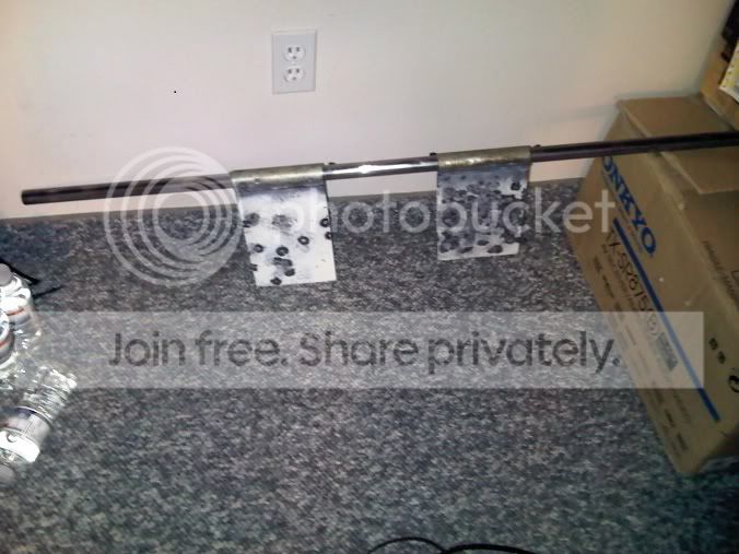

Silhouette targets
I made these a few years ago, they work well for the .22. I've also shot them with a .357 mag and they held up fine. I wouldent' use 1/4 inch steel for my high power rifle but the same target design would work. You could probably even find a Huge brake drum.
<edit> Since these photos were taken I have cut the counter weight off of the tops of my targets. It was an idea that didn't work.
Nic
