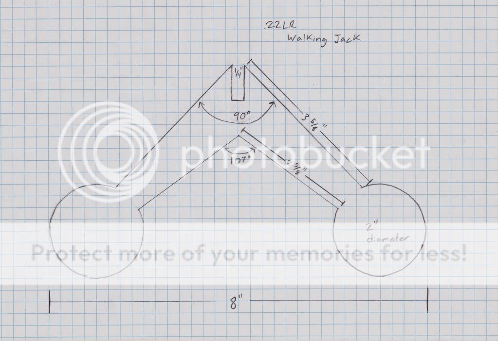

Here's the scan, it weighs just over a lb I think. the mini Hostage target uses a old door hinge and when you shoot it swings from one side to the other.

I forgot to add, the graph-paper I was using has 1/4" squares

I would definitely take it to a shop with cnc plasma or waterjet, I cut them out by hand with a torch and it takes a long time to get them cleaned up.
I did use 1/4" mild steel and if your just using a .22 on them they can take a ton of abuse even at close ranges. when I was testing them out I didn't get any ricochets. I think if you could get 1/4" AR400/500 cut by waterjet you could even use them for pistol calibers.
I was wondering how you cut them. I'm going to have to cut them by hand with a torch (good practice anyways... and I need it) so I'm glad to hear they can come out looking good.

I like the walking targets. They might be cheaper and easier to fabricate if you only had to use round cutouts. You could then use 1/2" rod to form the tetrahedron that interconnects them. Then you could just cut out rounds.
