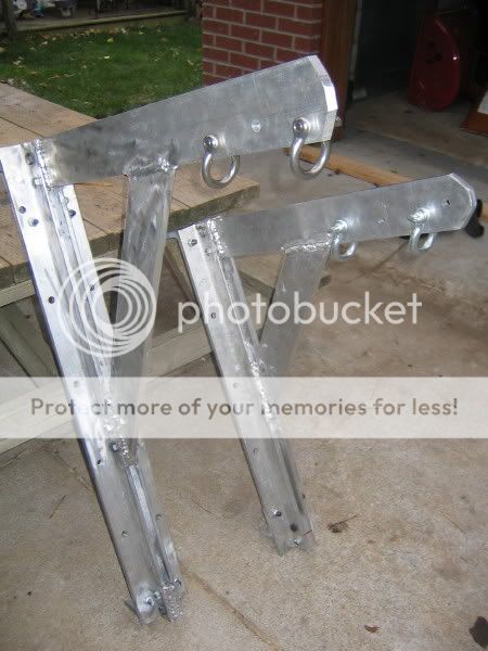

During last years' moose hunt, I had the chance to see a fellow's ingenious solution to hanging a moose. He constructed a sturdy homemade "L" bracket made of aluminum. When he needs to hang a moose, he finds a strong (8"-10") diameter tree and attaches the bracket to it using one heavy-duty racheting strap. His particular strap was purchased at Princess Auto and is rated at something like 3,000 lbs, the thing has a 3" wide extra thick webbing!
He then uses a 2,000 lb. automotive, drum-type hoist attached to a homemade gambrel and winches the beast up. He uses two hooks on the horizontal part of the hanger. He hangs the hoist on the one furthest from the tree and when he gets the carcass to the required height he hangs the gambrel to the hook closest to the tree.
I was fascinated by this simple and effective design. Upon returning home a welder FOAF ( friend of a friend...) was "volunteered" to make two identical one's for our group, I've attached the picture of them below. He made a smaller and a larger one, depending on which design performs better in the field, we'll have him make one more.
