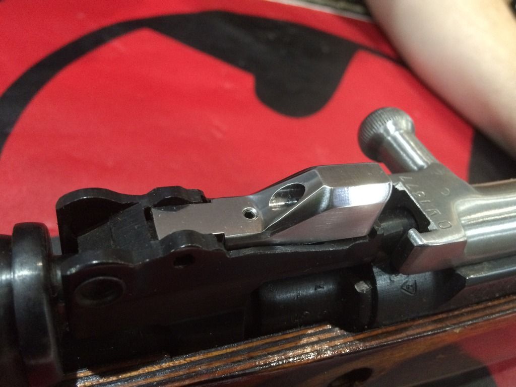

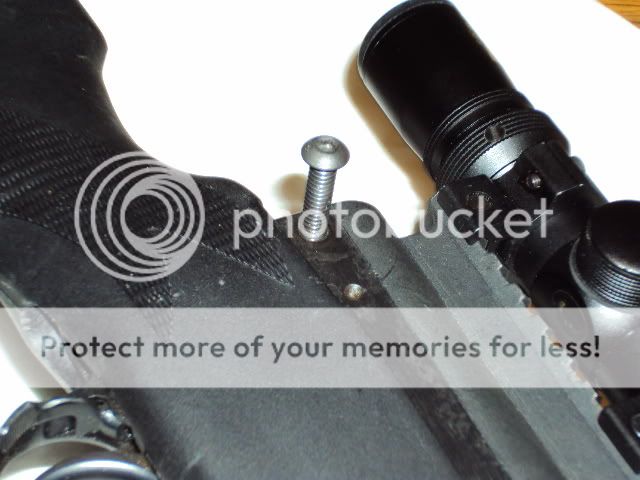

If you get a "See under" top cover scope mount, you can epoxy a nut in the "see under" channel to be a peep sight. And tap the takedown lever channel like Ganderite in the above link, scroll to the bottom of the thread (1/4-20x 1 3/4", button head, heat treated bolt).
You can convert the rectangular hole below to a circle:

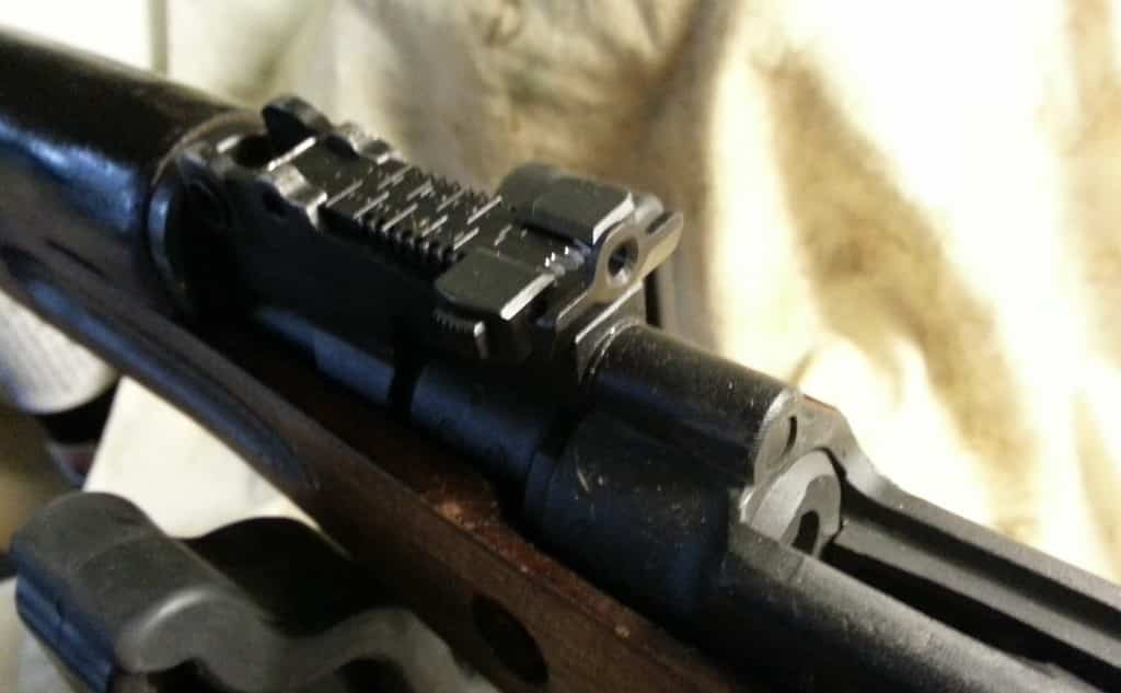

Tried the new Magwedge Raveneye sight and its excellent for close range shooting as well as far.
Trying to get some better pics up, but its not easy to photograph ... here the sight has been elevated slightly.
A top view showing the engraving of the numbers on the sight. I wanted this to look as compatible as possible with the rifle.

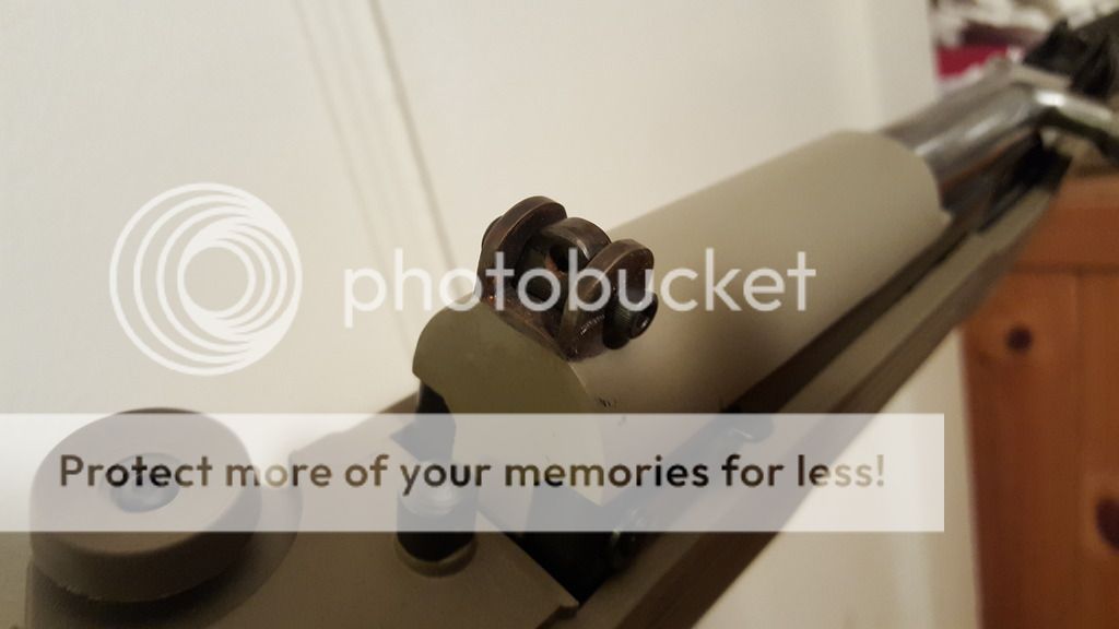

How about this DIY
This peep started off life as a NcSTAR SKS Tri-Rail and after removing everything screwed to the receiver cover, I cut off the front u shaped bracket and cut off the top of the rear bracket leaving just the ears which I rounded off at the top.
I then drilled and tapped the ears to install adjustment screws on both sides of the sight. The actual peep was a small nut that fit loosely in between the ears and drilled out the threads and rounded the top of the nut to smooth things out.
Drilled a small hole on each side of the nut to accept the ends of the adjustment screws and then cold blued the assembly.
Alignment was easy. Simply leaving the rear sight in place during the procedure, I was able to ensure that the rear peep would be in line with the sighting plane of the original sights.
At the range, all I needed was a small adjustment to raise the front sight pin and I was on at 100 yds. Averaged 2 inch groups at that range.

Most of the modifications I do are intended to be simple enough for anyone to copy and I also like to improve the lines of the gun as well as the balance. The peep was intended to look like it belonged instead of a add on.
