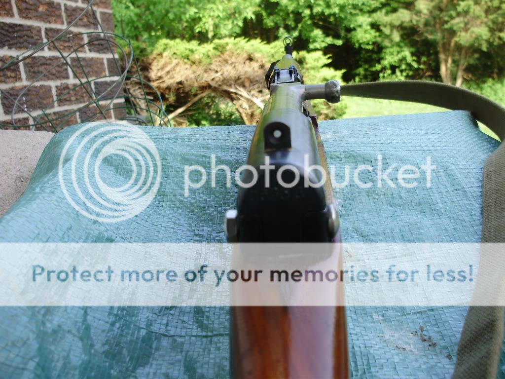

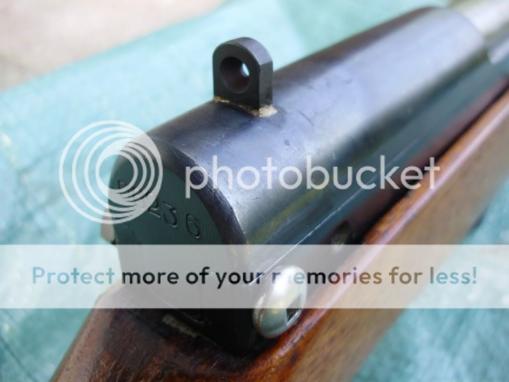

Made this simple peep from a Lee Enfield "L" sight.
Cut a notch in the receiver cover. Brazed the sight into position. Zero the rifle with issue sights and then braze peep into position that lines up with issue sights. Then remove the open sight and fine zero with the front sight.
