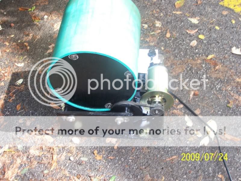

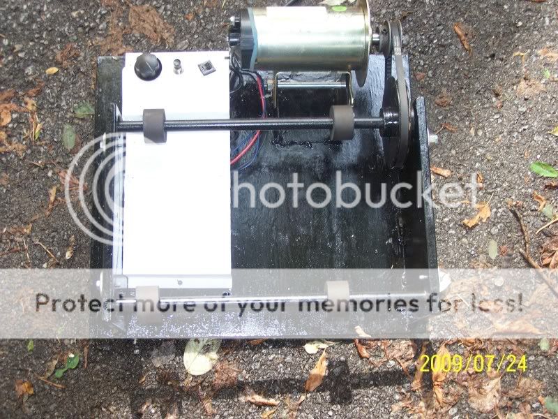

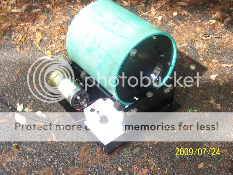

homemade tumbler
another update......had it sand blasted,then my young grandaughter painted it for me:)..child labor i know:rolleyes:..
alls i have to do now is just rig up some kind of simple bumper on each end to stop the drum from traveling on the rollers...
pics are a bit crappy as im crappy with a camera...
any one have 500 to 1000 pieces of brass that needs to be polished?i need to give this a test run,to see if it will do what it was made to do..
it will either ruin your brass :redface:or polish it up to look new again:)

this tumbler is done..........its going to a good home:D..........i hope it keeps working the way it did in my teasting of it for many years....
time to move on here:D
any one have another idea to make up a different model?im thinking of trying one on the same idea as a cement mixer..
using the same size of 12 inch diameter pipe:) for the drum:D..
thoughts and tips all;)
