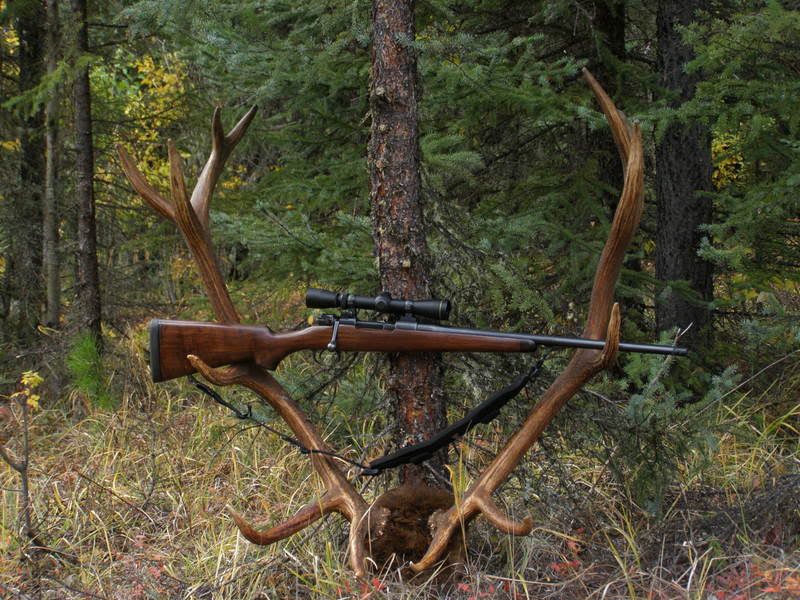

I'm certainly not capable of that but I did have an old barrelled action that I couldn't find a stock for so had a local chap make one for me. He even fabricated the trigger guard since I couldn't find one to fit.
