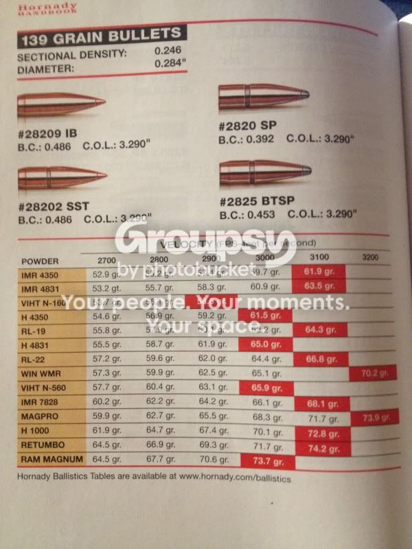

I would like to start some load development with the 139gr gmx in the 7mm rem mag. I am unable to find any load data on their website but was told that you can use regular cup and core data as long as the weight matches.
Can anyone with a hornady reloading manual post their data for the 7mm rem mag and the 139gr sst? According to Steve Hornady I can use this same data with the 139gr gmx.
Interested in Retumbo, H1000, H4350 or H4381.
Thank you kindly.
I haven't done much work with the GMX yet, but the other monometal bullets that I have developed loads with, showed pressure signs with slightly less powder that traditional cup and core bullets.
I will work up as usual and have noticed the same with tsx/ttsx. Hornady says their data is interchangeable between cup and core and their gmx.
