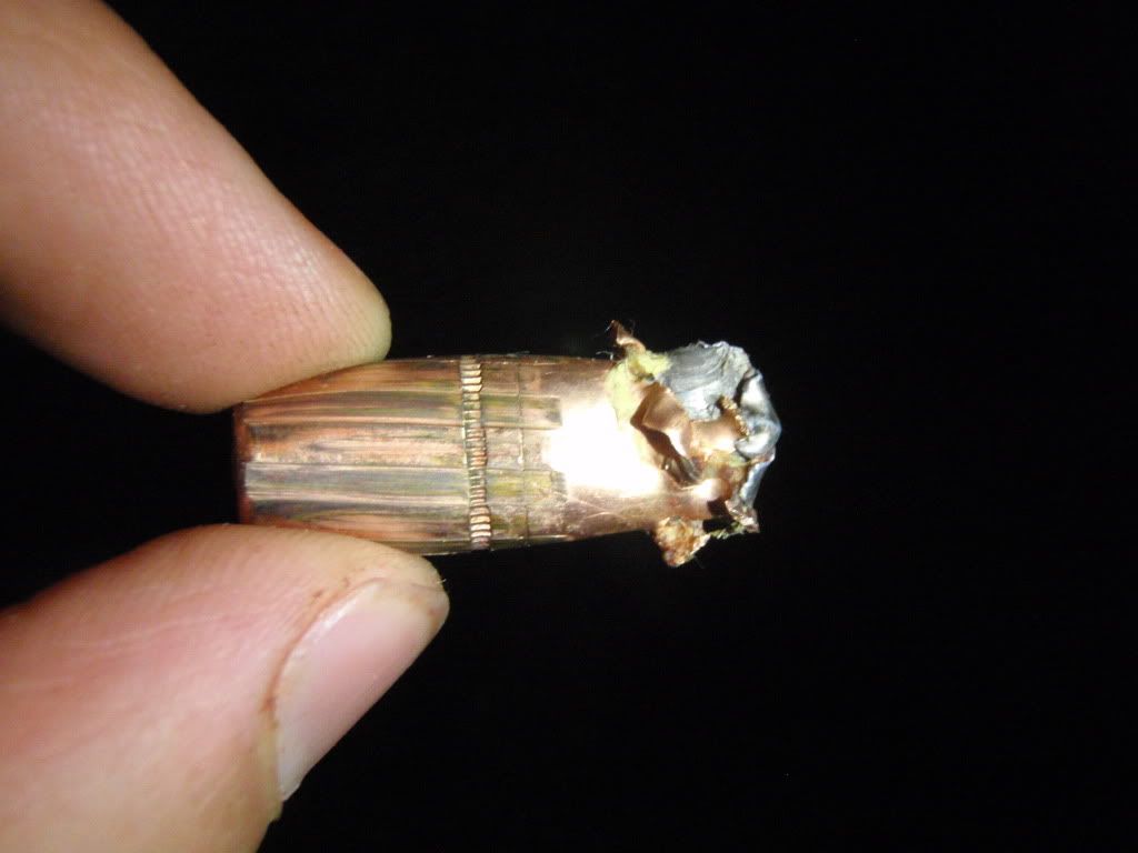

I have a pile of these put away as well. They were fine on deer and a wolf but I'm a little leery on the bigger /nastier stuff...........Harold
I got some too back when they first came out. When I bought them I opened the box and immediately noticed it did not look like the normal Hornady design. These having a flatter point and 6 skivvies stamped into the bullet nose to help initiate expansion. Around that time I also got a box of 375cal 270g Hornadys and noticed they had changed them over to this new design as well. It is not a coincidence that people started complaining about BOTH the 9.3 and 375 bullets being "soft", "over expanding" or not penetrating as deep as was desired or expected when the new bullets hit the shelves. Don't know if anyone else has made the connection but I shure did.

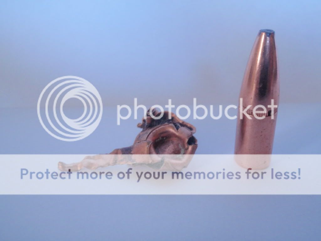

Here's a 180gr Hornady [ I know not a 9.3 but same company] hit a mulie frontal chest shot found in off side flank... never expanded ! The bullet looks like it flattened lengthways. Out of a .308 Norma magnum at just under 3000 fps.IMO Hornady has done something to their bullet jackets in the last 5-10 years cost/corner cutting and won't admit it. I look for the older Red +White boxes at gun shows.Those were good bullets.Have had explosive results with 130gr in a.270 as well.Many inconsistencies. Harold
Frontal chest shots can spin bullets around backwards Sounds crazy but I experienced the exact same thing as the bullet you have pictured. It was a 170g Speer out of a 30-30 at 75yards. Frontal shot on a whitetail, bullet hit just on the side of the sternum made a 2" hole, punched a 30cal hole through everything from then on, could see it perfectly in the stomach lining and diaphragm. I found it logged in the rear leg bone backwards. The bullet looked like yours.
I have also seen funny things with bullets in the spine. Sharp interlocking bone at odd angels make for weird wound channels and funky shaped recovered bullets, if they don't explode.

I too have had bullets hit shoulder/spine and end up spun backwards or tumble, sometimes weird stuff goes on. I can understand now after seeing whats left of 286 grains of hornady interlock why I wont be using them in the near future , thanks for posting the pics Harold.

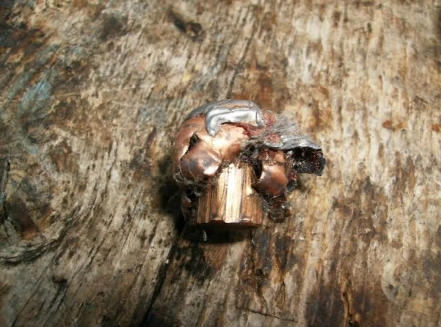

Here's a couple pics of a 286 grain nosler partition stared @ 2350 that went almost 4 feet through a good sized black bear and was found just under the skin after breaking the right hand shoulder. Its pretty much what you'd expect of a big partition
