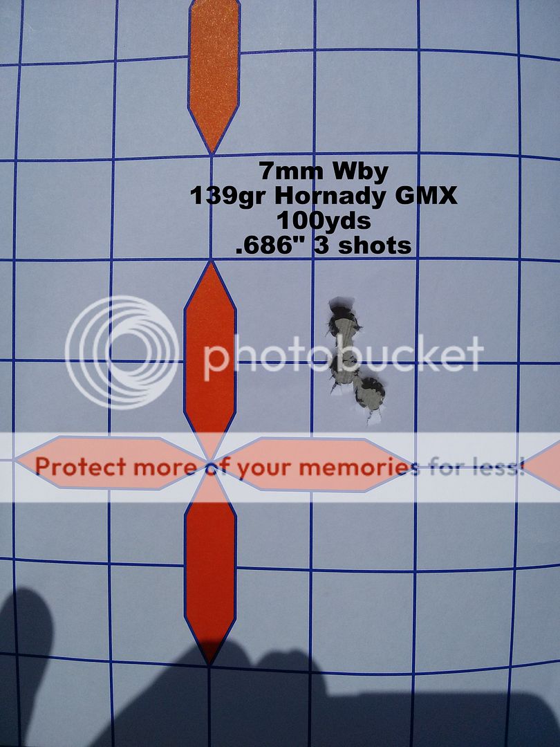

Picked up a box of Hornady factory ammo for my 7mm Wby, and took her out to the range today to sight in for my upcoming bear hunt. Quite impressed to say the least!
Rifle is a Mk V with a 24" barrel and all factory original.
Its OK just hold slightly left ! LOL RJ
Above the aiming point would be understandable, but to the right wouldn't be likely, for a final zero. The reason that I asked, is to see if the group pictured was just a cherry picked group, or if the other groups were similar. One groups says very little about the potential of a load, or a firearm.
