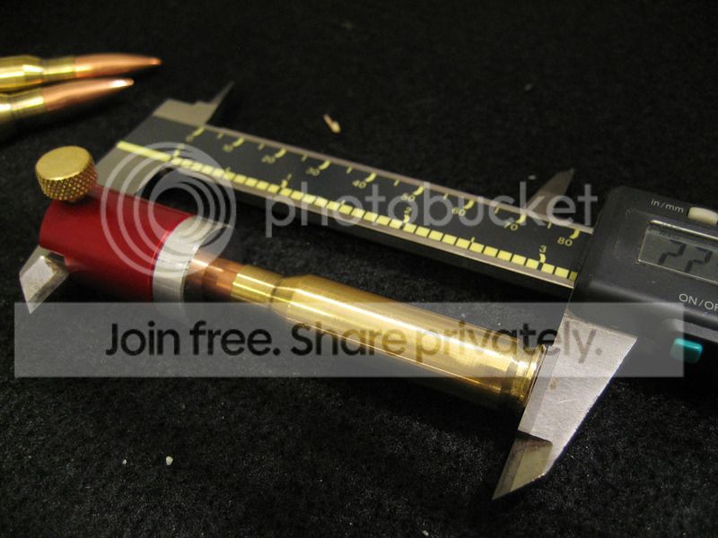

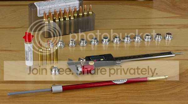

are you measuring to the tip or to the ogive? the ogive is where it is important. the tip measurement will drive you nuts fast
Hornady bullet comparator mounts on your calipers .There are different inserts for certain caliber ranges.
The tool for measuring the O.A.L required ( or for measuring throat erosion) is shown as well.
