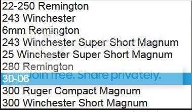

To see what cartridges Superperformance can be used in:
Hodgdon website
pick 280 rem
leave step 2&3 on any
step 4 pick suprform
step one drop down will list cartridges it can be used in
Works for all powders
I use Suprform in my 280 Rem 3156 fps with 120 TSX
