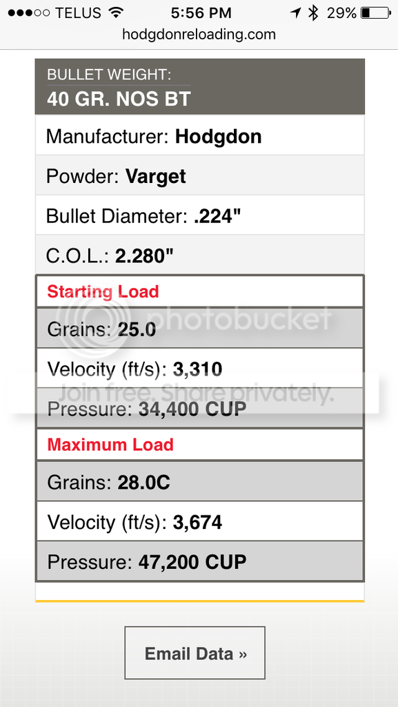

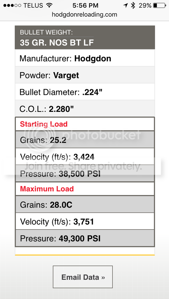

There are 7 loads for .223 Rem (40g to 63g bullets) for Hodgdon Varget on the Hodgdon retail website here:
https://www.hodgdon.com/varget/
1) select .223 Remington from the -Cartridge (Required)- drop-down menu
2) DO NOT select any bullet weight from the -Bullet Weight- drop-down
3) now click the "GET RELOADING DATA" button and the seven loads will appear...
Please note that this is not the Hodgdon Reloading Data Center. It is Hodgdon's retail website and all possible calibers and bullet weight "recipes" for any given powder are directly accessible on the respective powder description page.
This is perfect when you have a powder and you scratch you head and say "I wonder what other calibers I could use this powder for?"
neat huh?
