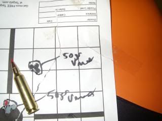

This is how my Kimber shoots the 50gr Varmint Express. 6 rounds and the gun was ready to kill, done deal.
