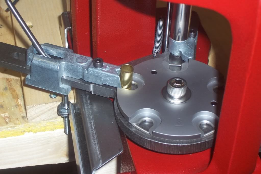

I just can't get this thing right. The cases always bind up as the go over the retaining spring. I've adjusted up, down and everywhere in between and it just doesn't work :mad:
Any ideas would be greatly appreciated.
Yeah, I'm getting pics right now.

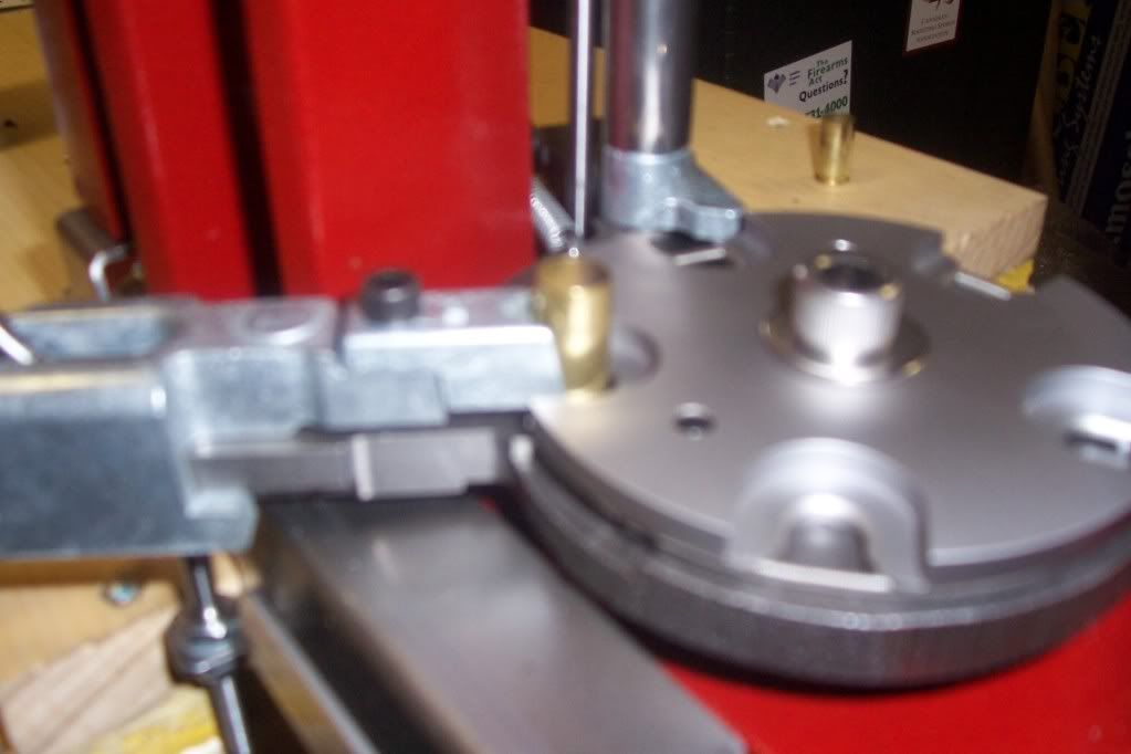

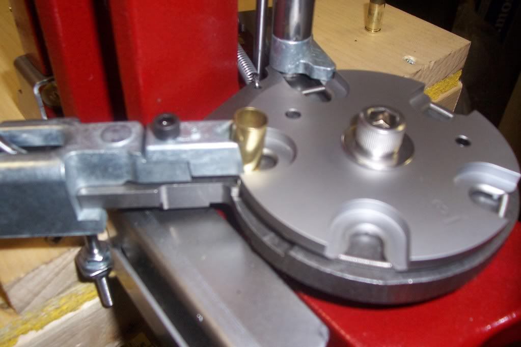

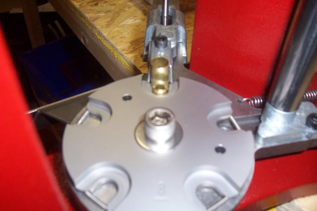

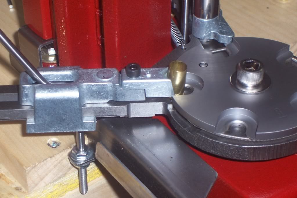

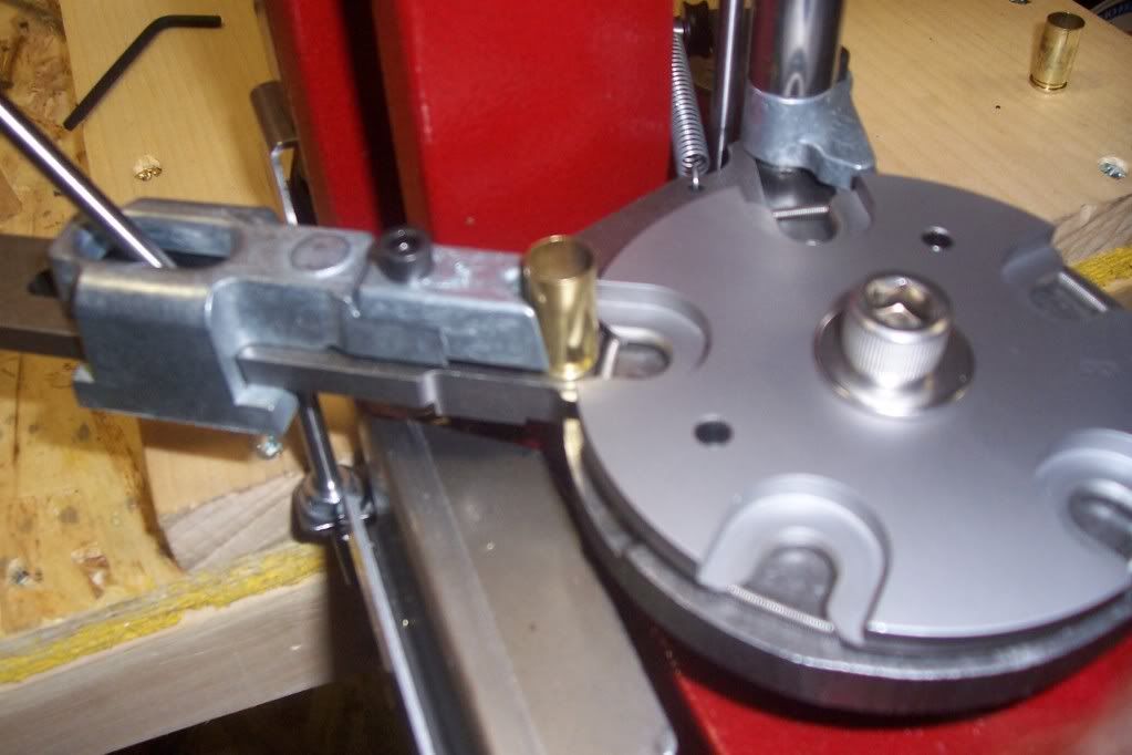

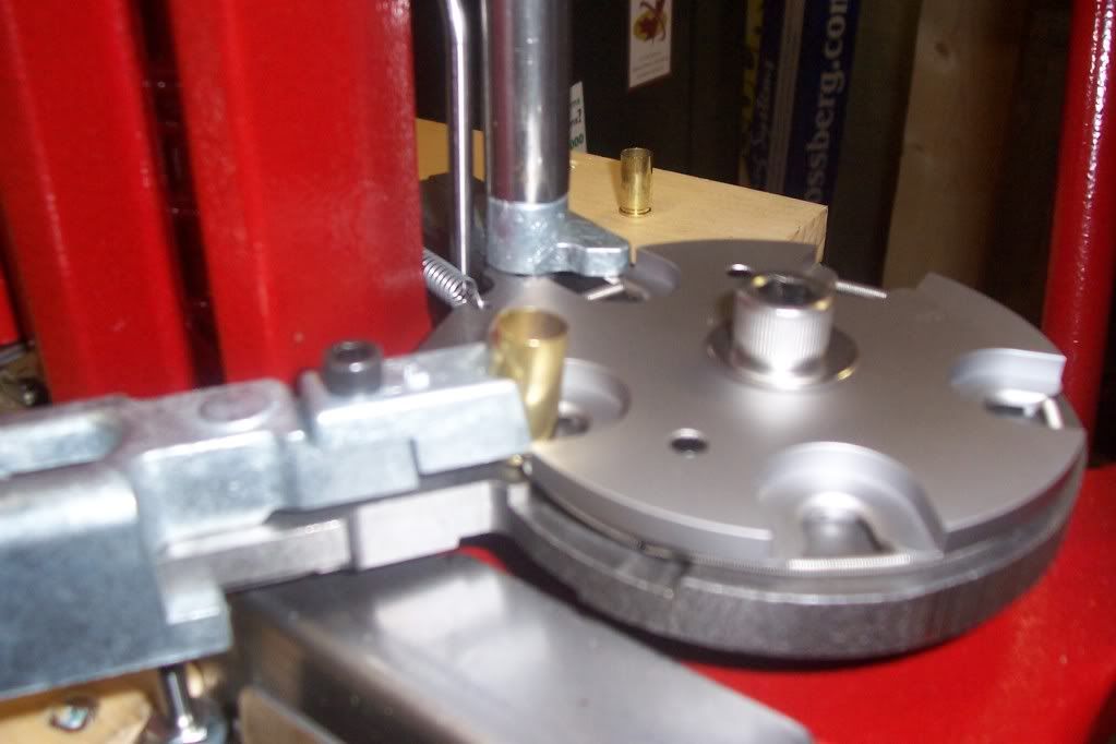

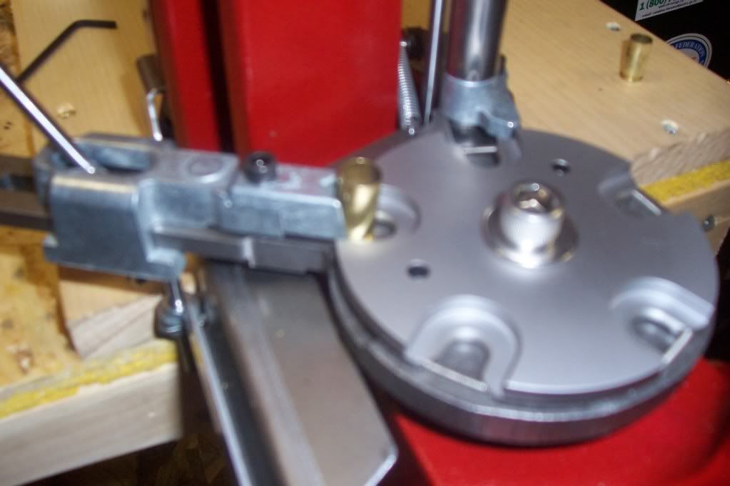

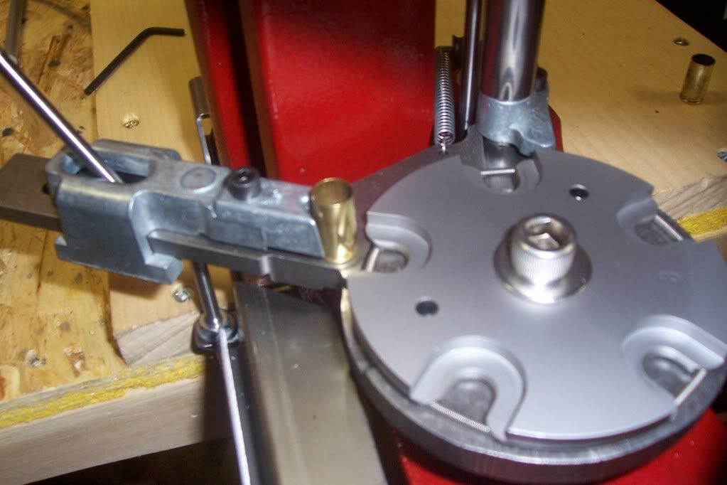

I'm using V block #2, as the case travels over the retaining spring, and it tilts towards the center of the shellplate, locking the case groove into the shellplate, its not much, but enough to stop the forward movement into the shellplate.
Approach the shell plate
Shellplate locked in place
Going over the spring
After manually adjusting the case to be upright
The first thing I notice is your adjustment rod is maxed out, there are no threads showing, mine is not like this, this would leave me to believe that your shell plate timing is off or different from mine?
Also I would assume your cases still have the primer in them, I was having trouble with my .223's but thought it was mostly due to the primers missing... I did read somewhere there was a fellow having a similar problem and he put a washer under the shell plate, it is possible that the brass is fitting tight between it and the ram top causing it to tip...try a washer under the shell plate...

Yeah, the timing cam length is weird, especially cause the manual said start with it half way (which would be way to soon).
Would it have to be a big washer under the shellplate? The shellplate is notched to fit a certain way onto the drive, also, wouldn't a washer mess up the timing since the ball detents won't fall into their holes?
I think you would need a machine washer, I am thinking a very thin one is all you will need, it wont take much, I will have a look at work tomorrow and see what we have if I can find one I will send it to you....
You could cut one out of bristol board, I think it might work....
Cool, I was just fooling around with it, I tried running it without the spring, and I was able to feed a federal casing 100% of the time...no problems.
:confused:
So is the primer catching on it or the edge of the case, are the brass factory once fired or have they been reloaded before? Maybe the primers are not seated fully and catching on the spring?
Do you have a different spring to try? Is there any chance something is stuck in the grove where the spring rides? You could make the channel deeper where the spring rides but it would be a pain in the ass....
Is that a 9mm case... I had this problem with my 380 auto's the brass gets caught up on the spring and will not enter the shell holder properly right?
I think the problem is that the brass is to light... I started to load 45 acp with it and it worked brilliantly.
Yep, it is 9mm.
It doesn't look like the primers are catching on anything, the case just rises a bit when going over the spring and then it gets jammed when going into the shellholder.
I cycled a few .223 cases with no problems, they went over the spring and back down but entered the shellholder properly
Notice how the primer shuttle is jammed back too?
Good diagnostic technique. Now it's either the spring (oversized), the shellplate (cut too low) or your cases (out of spec). We can ignore the cases... or you could mic some of the rims and see ( I think it's 0.035", but check your reloading manuals ).
Then call Hornady.
Butchery. Hornady has a warrantee for these things - messing with washers just means "call them" and get it fixed.
This is what I was referring to when I read some where that someone was having the same trouble and shimmed the shell plate, i see no reason why it would not work, maybe Jarlath can shed some more light on what he did?
I also am curious, mine was fussy at first too but with some tweaking and a few thousand rounds it seems to be good now, maybe my spring has more ware and tare on it....
