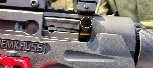

Pretty much always stovepipes. No extracto.
Like this- (Not my pic, for illustrative purposes only)
1678070548104-jpeg.190656
Thanks Scotty, I consider anything that clears the chamber to be extracted and if it clears the receiver it's ejected.... stove pipe is a no ejecto in my terminology but I appreciate the clarification on what you were experiencing.
