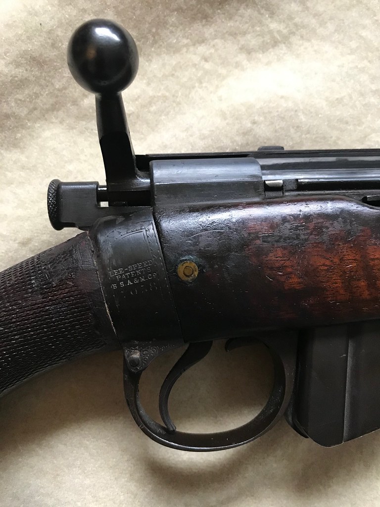

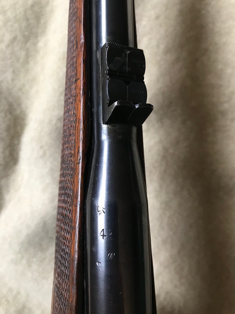

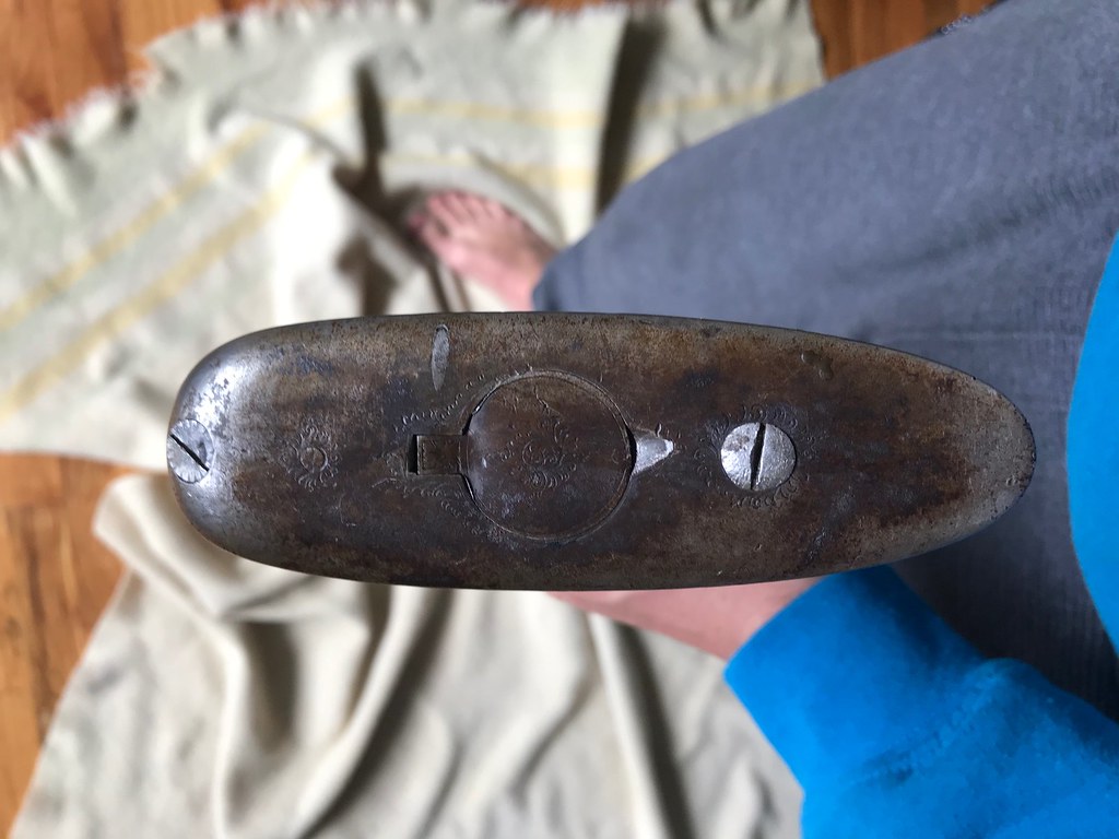

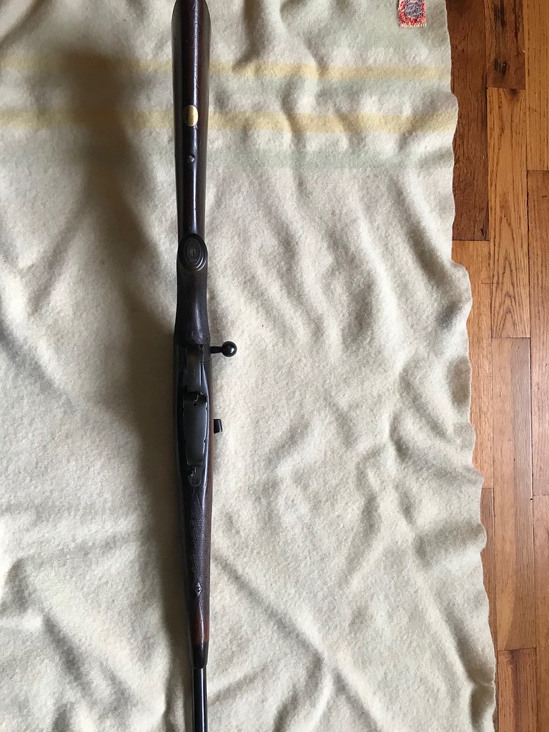

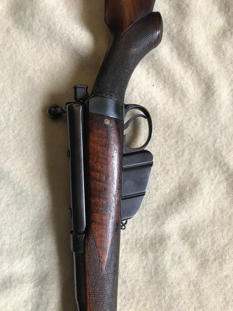

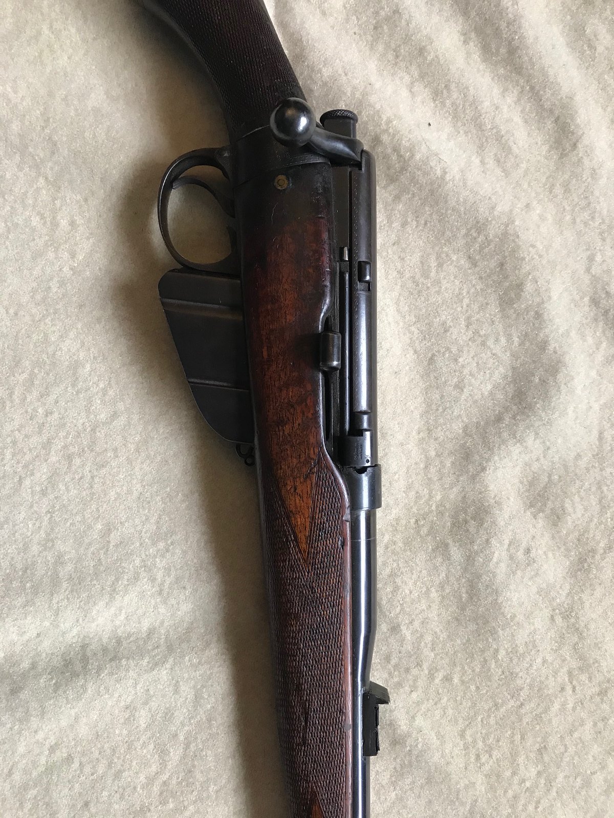

Thanks for the info, right now its at my parents house in Nova Scotia but when I go back in a few years ill dig it out and check it over again, I regret not bringing it here with me, there is a few times I wished I had it here.
I believe the mag is the one that came with the rifle the engraving matches and the amount of engraving is also consistent with the rest of the rifle.

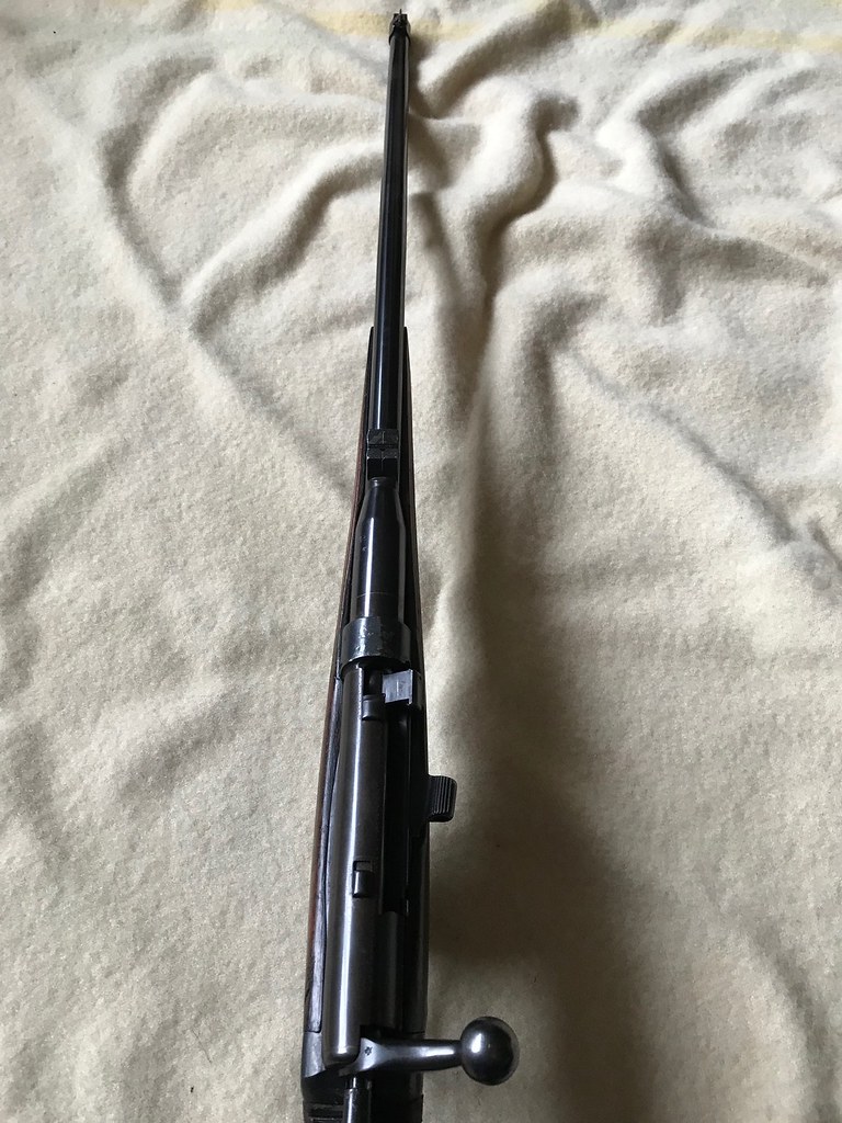

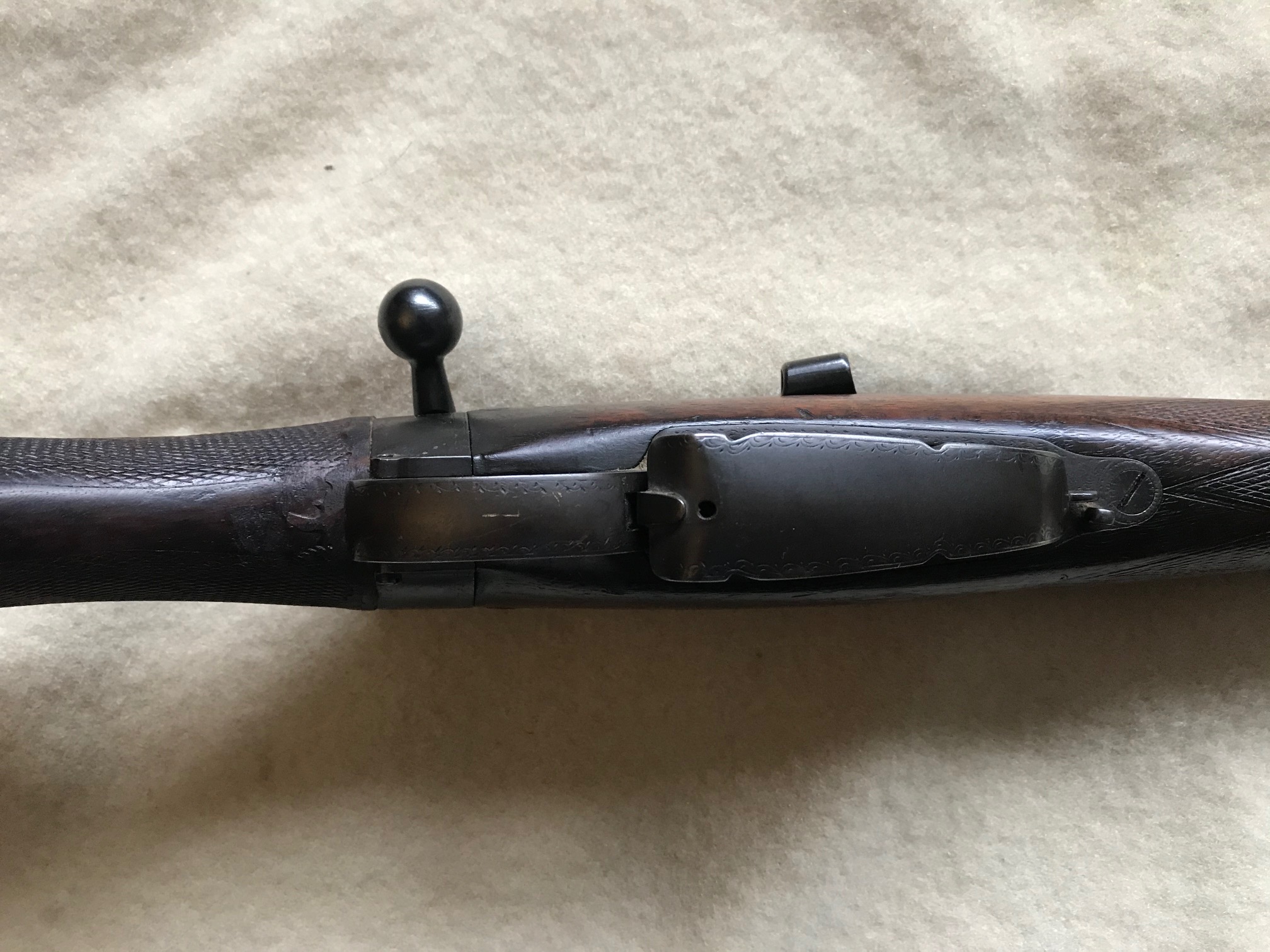

here are the only pics I have of it, they were sent to me by a CGN'er when I was buying it in 2020

It looks to me that although the magazine & the other "bits" of the rifle are from the same time period, the style of the engraving on the various pieces do not match. The engraving on the magazine and dust cover appear to match (perhaps taken from 1 donor rifle?), but the engraving on the trigger guard / floorplate is a bit different (from another donor rifle?). Compare either to the king screw engraving.
Bear in mind, however, that I am looking at photos on my monitor that were taken by a camera (phone?) at whatever megabytes & then loaded onto a computer & then uploaded to the host.
That's my $0.02 worth, FWIW!
Jim
