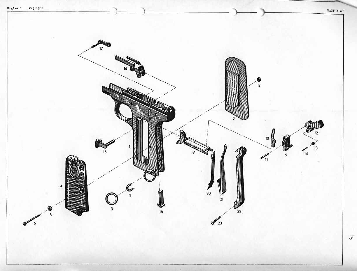

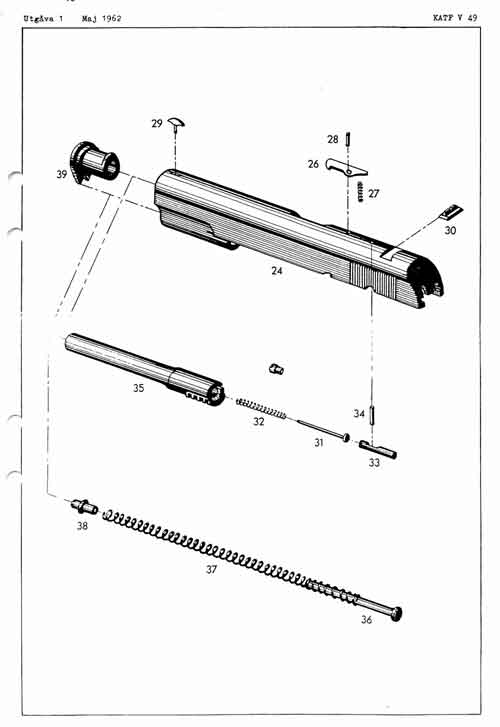

Since I mentioned re-assembly, there are about 3 different ways to try to reassemble the pistol, but two of them will get you 90% finished and then you'll realize you can't fit the grip safety and have to start over! I gave up trying to photograph re-assembly as much of it is internal and too finicky to photograph without a cutaway pistol, but in general, the order is as follows (reference the drawings at the bottom for part numbers):
1) Insert the trigger (19)
2) Install the mag release (18), springs 20 and 21, the automatic safety (22) and the pin (23).
3) Install parts 9, 10 and 11. Note the orientation of the hooks on part 9 and the direction part 10 faces. You insert these through the trigger opening where the mag goes.
4) Install feed lips (16).
5) (12, 13 and 14) are an assembly - keep them assembled and now re-install them using the safety to retain. This is a bear to do and a third hand helps. You have to compress the hammer spring in the notch just forward of the hammer roller and get the safety pin through the frame and hammer. By far, this is the hardest part of assembly.
6) Install the slide stop (17).
7) Install the grips.
8) If you removed it, re-install the extractor assembly to the slide.
9) Install the recoil spring 36,37 and 38 to the FRAME.
10) re-install the firing pin to the slide.
11) Put the slide back onto the frame taking care that the recoil spring button slides into the slide's dust shield. You will need to apply a little force to get the slide to go over the hammer, which you should #### first with your finger.
12) Put the slide at the slide lock notch, then insert the barrel and rotate it 90 degrees. Disengage the slide lock and allow the slide to come forward until you can engage the safety into the take-down notch. rotate the barrel back to the upright position to engage the locking lugs. Now disengage the safety and allow the slide to go into battery.
13) Install the barrel bushing - Done!!!
