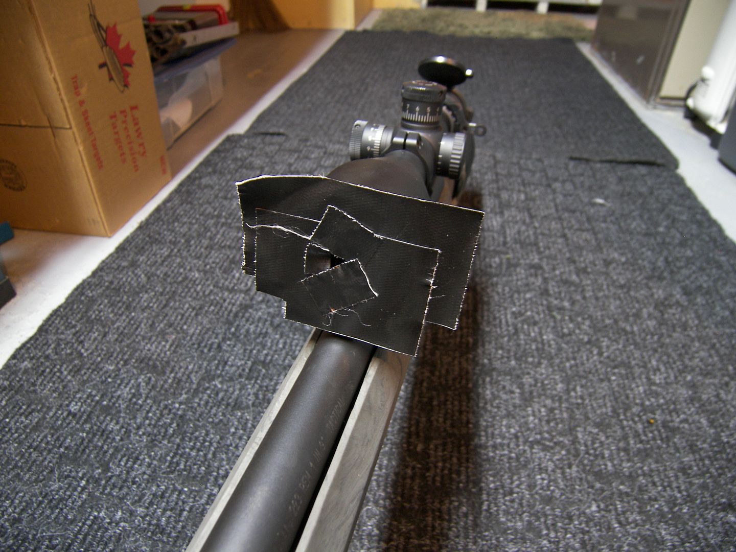

Apparently all you need to do is cut a piece of opaque plastic same diameter as your objective then cut a centers hole 1/3 D of your objective lense, and place that piece in a scope cap. Acts like an aperture.
Has anyone tried this? I think I will give it a go and let you guys know how it turns out.

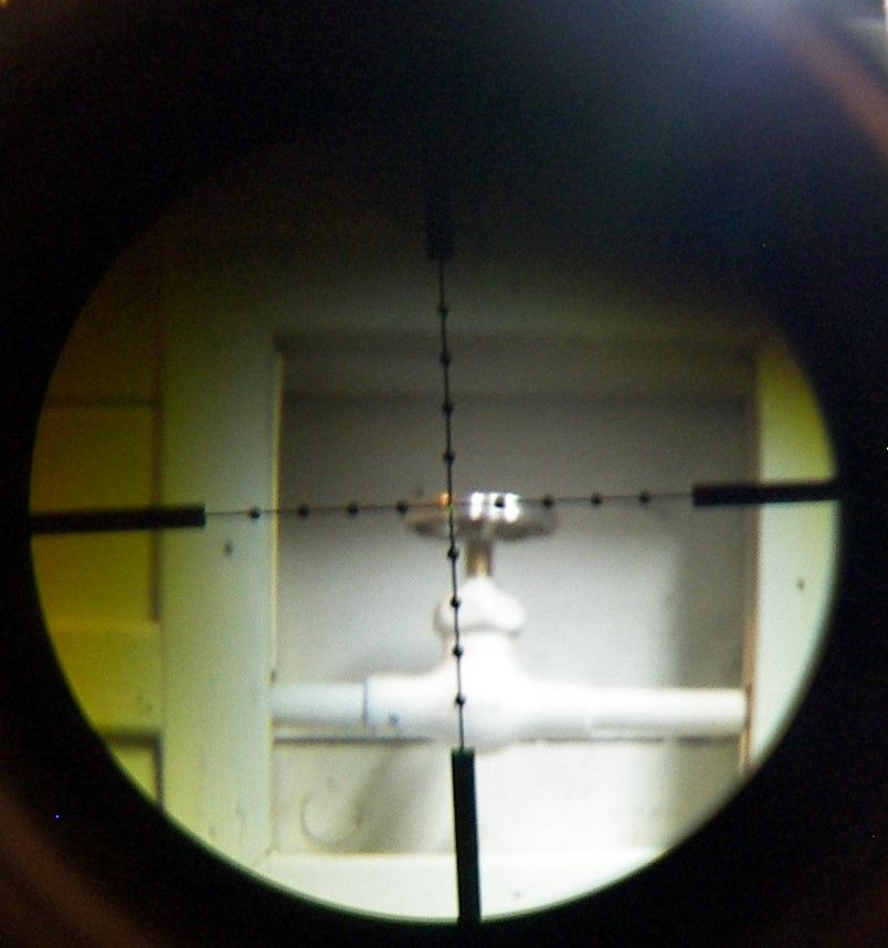

Can confirm this works. Did it today, and was able to focus my ERS 3.5-21 at about 12 feet. The target needs to be very well lit for the reticle to show up, because you're reducing the amount of incoming light substantially.
Booya. What magnification were you able to focus on?
trijicon accupoint, TR23, 14 feet on 5x. image is actually better, but my camera skills are balls.
you also have to have your head exactly right in order for proper view, like when running at max magnification.
