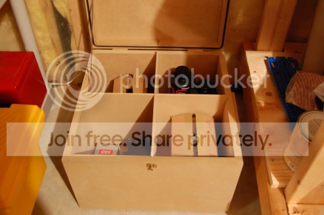

Sturdy 2" Plywood and brass hardware (except the lock). Ostentatious warning stickers in case the commissars from the government want to nit pick over the letter of the storage regs. Mind you, I built this before they changed, so admittedly it's overkill, but since I also use it to store ammo on the shelf below the powders, it keeps my kids from getting into it.
