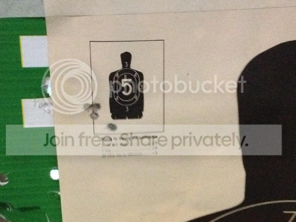

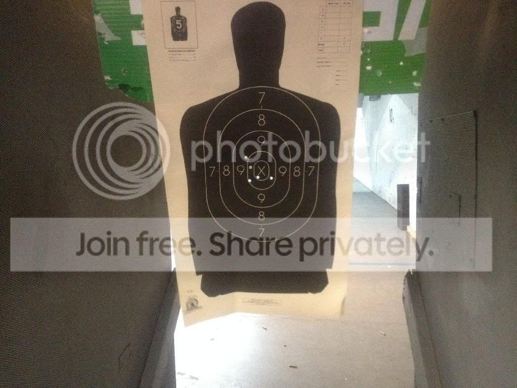

I guess everybody is different.
I bought 2 of the Norinco 1200 round crates from Canada Ammo last spring when I was running low on Hornady FMJ's.
I first ran it through my Norc then for fun I ran some through my Noveske Afghan
Both groups were shot slow fire at 50M indoors from a front bag using an EOTech.
The first target is the Norinco CJ 95.
I have had 0 issues with mine as far as accuracy or malfunctions or primers popping.
I would actually buy a few more crates for plinking.
The second target is my Hornady 55gr FMJ handloads USING 25gr of XBR and CCI primers.
Although there is a vast difference in group size the subject would be quite dead in both instances.
I will perform the same test once I put a scope on the Noveske and get outdoors to a 100y range.

Biggest Problem with Norinco ammo is that there is no consistency. Some guys have no problems other than half ass accuracy and others have nothing but problems. Then there are the really rare ones that say their rifle loves the stuff and they are doing 2-3moa with it.
I was out shooting with a buddy who had his XCR-L with him and he was doing around 6 inch groups at 100yds off a bipod with Norinco ammo so I let him try some American Eagle 55gr I had and his groups went down to around 3-4 inches.
That first target is not what I would consider even decent accuracy for 50yds, second one is much better. I don't consider whether a person would be dead if I made a 6 inch group center mass at 50yds a good measure of accuracy. I like most of us are not in the military and will never shoot at another human, I shoot my AR's as target rifles, and my HK and ACR will also be used for varmint and predator hunting, therefore I judge my rifle and ammo performance in inches and 4-6 inches at 50yds is far from acceptable for me. If my semi auto rifles can't print 2-3 inches at 100yds off a sandbag I try other types of ammo and if that doesn't produce better groups I sell the rifle. I am not satisfied until I am getting 1 moa from my rifles, my HK is there with my handloads and I'm just starting load development on the ACR's non restricted barrel.

Just to be clear the Norinco group was inside of 2" so 4 MOA.
The 55 gr Hornady FMJ were right around 3/4" or 1.5 MOA.
If the Noveske won't do .75" at 100y with 69 or 77gr it will get re-barreled.
I am confident it will be to my liking once I develop a load for it and get to my 100y range.
