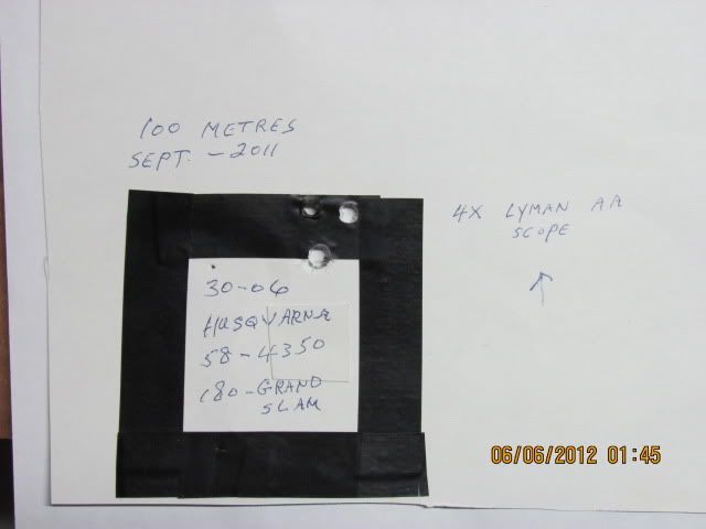

The rifle has a steady tapered barrel 23 3/4" long, and only .562" at the muzzle. I have an epoxy saddle on the front of the wood, to put a fair bit of upward pressure on the barrel, making it superbly accurate for its weight. The rifle is destined for a son and grand son, so I put a good period correct scope on it, a 4X Lyman All American.
Here is a target that I shot four shots at to check scope setting. Note one hole is a double and I think the four holes are around .6".
