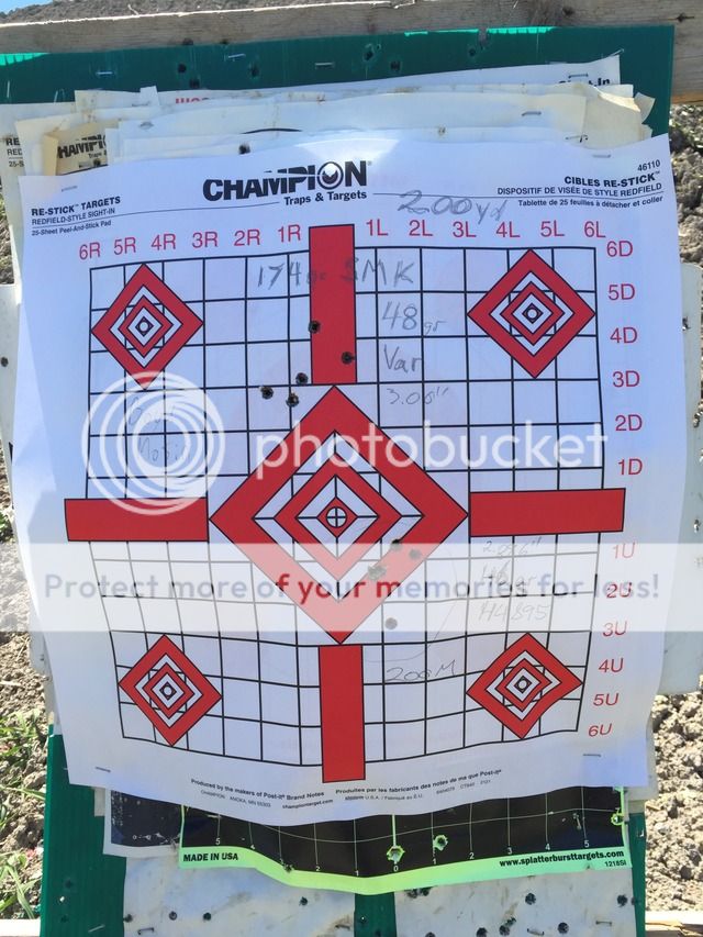

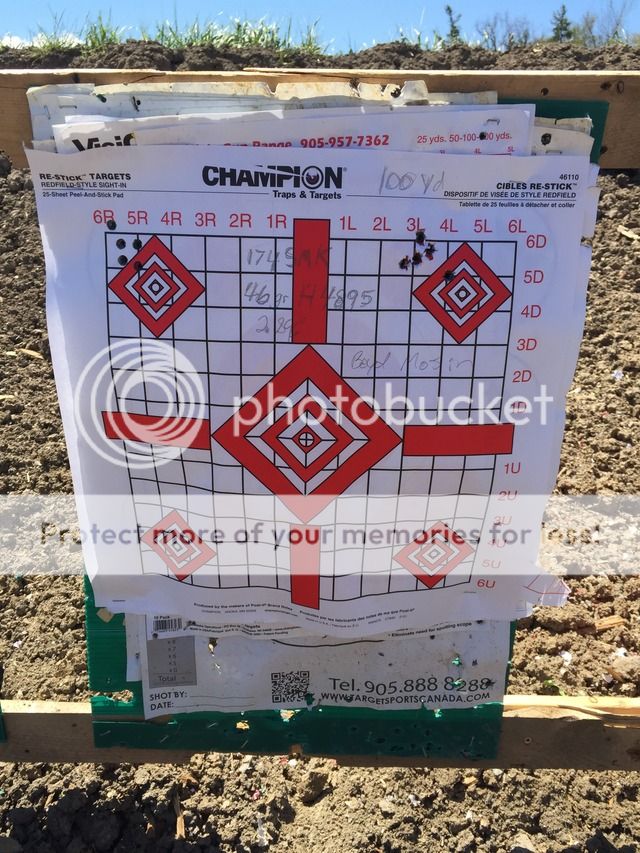

So I got to the range today with my hotter loads and I'm happy to report there was an improvement.
Those are by far the best 200M targets I've shot with this gun. Much better than the milsurp ammo it seems to do so well with at 100M.
My Chrony numbers got much better too. Still not great but better...
I was getting some pressure signs with the Varget load so I may take that back a bit. After that I may be able to proceed with playing with seating depth next. Is that even worth my time and bullets? Am I likely to see an improvement with a Mosin? I recognize its not a true target rifle.

Thanks for the reply Willy!
The reason for the difference in COAL is due to a suggestion in this thread that perhaps being seated just off the lands is causing some disruption if my seating isn't exactly on. I don't have a comparator to double check. I took the load I shot the most and made it longer right into the lands to see if that changed anything. For the other powder I used my standard COAL. The difference this time was both were at the high end of the pressure curve. They both shot very similar and with similar numbers so I'm thinking my COAL wasn't causing the varied velocities I was seeing.
It's good to know about your friends Tikka. I'm sort of set up for this caliber with lots of milsurp ammo that shoots great in it and plenty of hand load components. I wanted to test the limits of what this caliber can do before I got into another gun and caliber.
