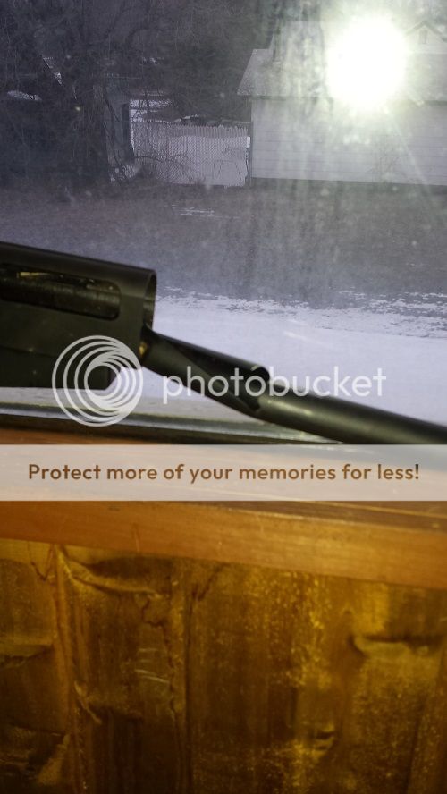

Do you guys know a good way to smooth out the tabs on the mag tube?
Edit
ya sooo..... The socket don't work it got stuck good. So good infact that I screwed up my grizzly now I need to buy another shot gun and convert that into a 878 magfed still worth it in the long run.
here is the mess I made,
Man that's harsh. I've done it a number of times with no issues. I always give it a shot of wd 40 though
How on earth did you get it to fracture like that!?! If you can find another receiver with issues, you could heat up the solder, remove that tube, and put in a new one. Maybe try Dlask?
Well when it got stuck I put it in a vise put a 3/8 driver on it when that didn't even budge I used my 18.5 barrel for some leverage.:(
Mine was stubborn to the point that I was afraid of bending it so I drilled the tabs out instead. The holes are covered by the barrel ring anyway.
Good luck.
