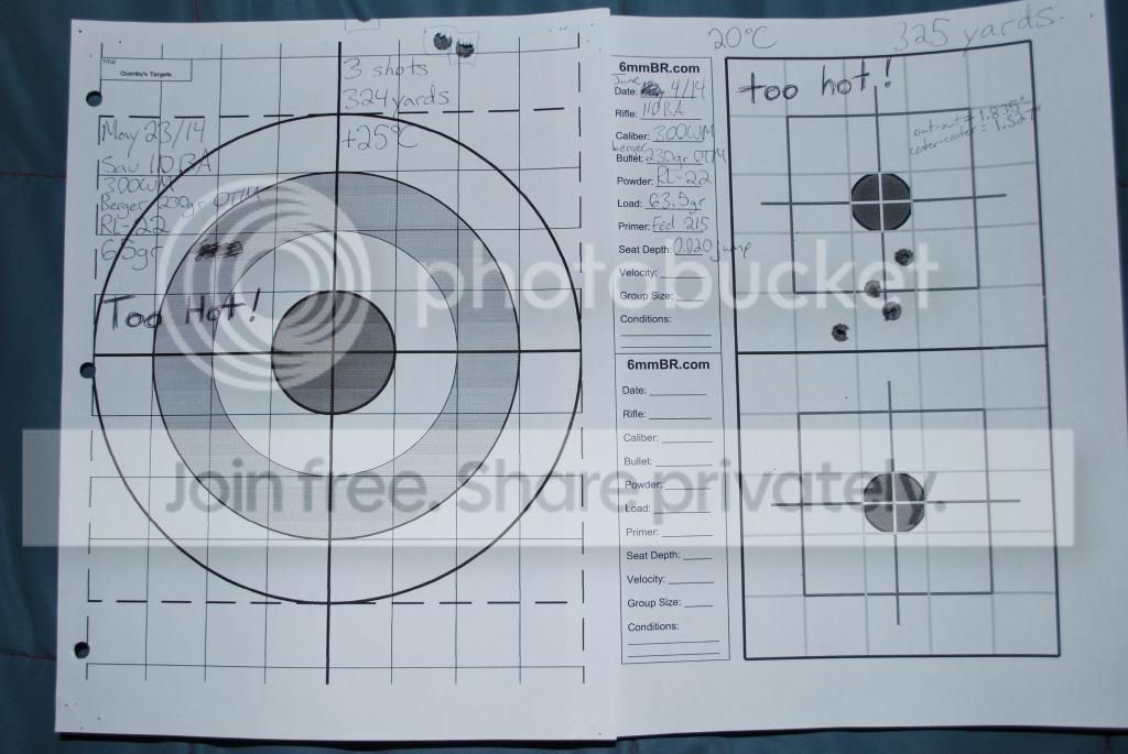

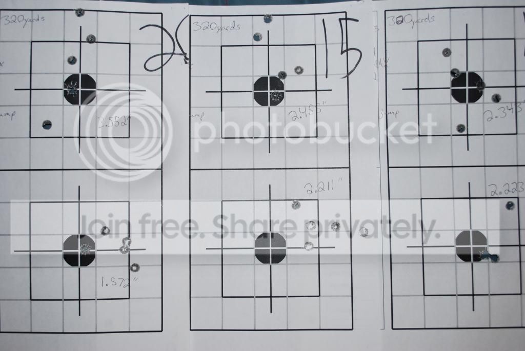

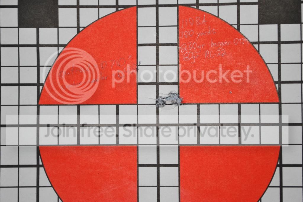

I’m starting to get an idea of how much the bedding job improved accuracy. I was confirming my zero and shot a nice tight 100 yard 3 shot group.
First I will post an average from before. 6 – 5 shot groups fired at 320 yards. All the same bullet and powder charge but 3 different seating depths.
These are some load development targets from after bedding. I’m using a new bullet and trying to find a powder charge. 2 groups fired at 324-325 yards, both quite a bit smaller then the pre-bedding groups.
Last is the 3 shot group I fired today when confirming my zero.
I’ll keep the few that may be interested posted on how load development goes.
