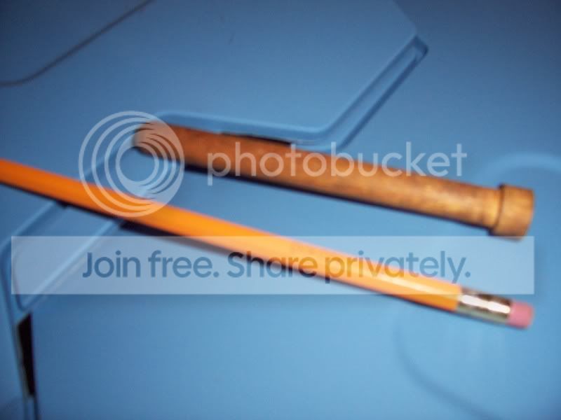

Looks too big of a diameter to me and may jam. Here is an original from a 12ga 1148. It is only 7/16" diameter on the small turning.
