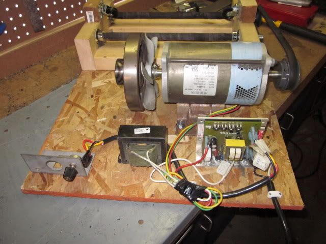

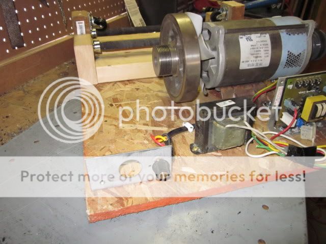

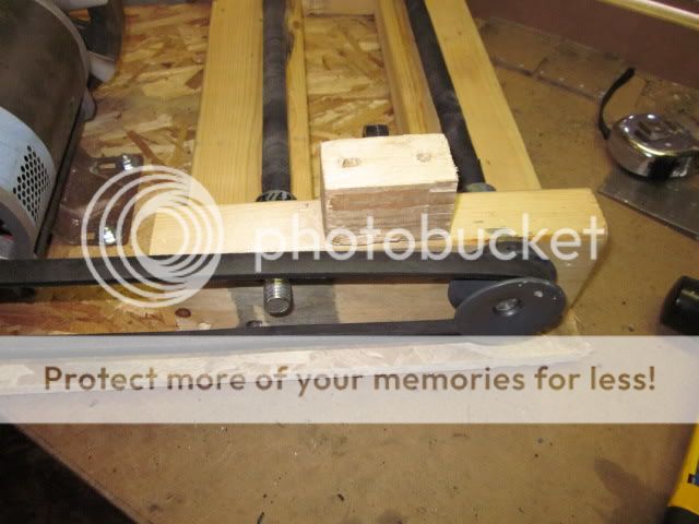

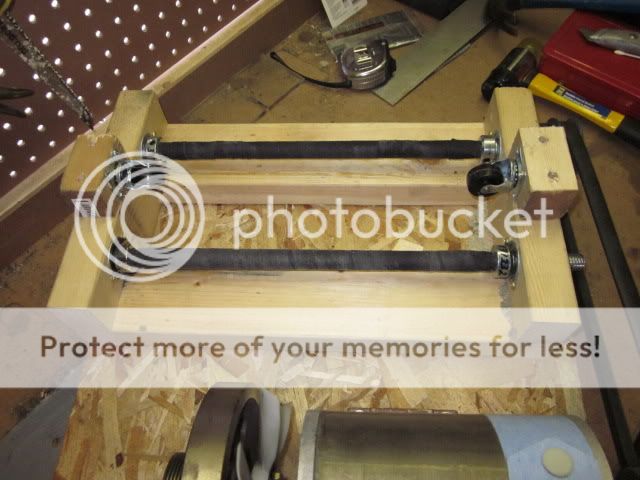

So I cobbled together a very crude mock-up of what I wanted the tumbler to look like after watching lots of you tube videos. I did a rough layout on my bench with a piece of wood, some crude bearings, some redi rod, a couple of pulley’s and an old treadmill motor and controller. I put a roller on each end to prevent the drum from walking across the shafts. Threw it all together and tested it out and it worked great.

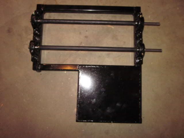

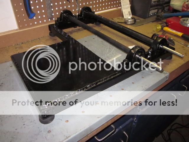

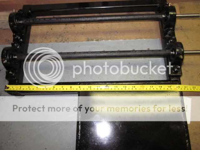

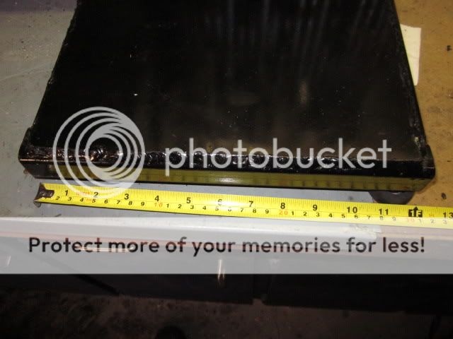

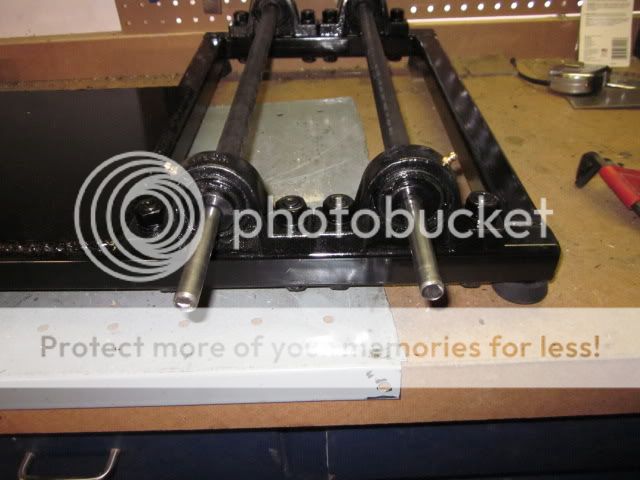

I then saw a you tube video of a design I liked and welded up a steel frame and used some of the posters idea’s on what to cover the shafts with and away I went. Had trouble with the bearings not turning correctly but after I ran them for a bit they loosened up and are now working great.
http://www.youtube.com/watch?v=TtVHvMNf6tM&feature=youtu.be

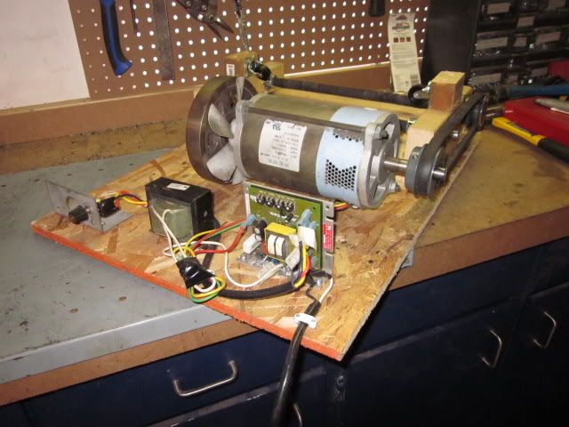

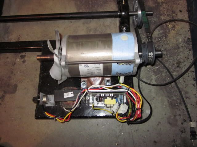

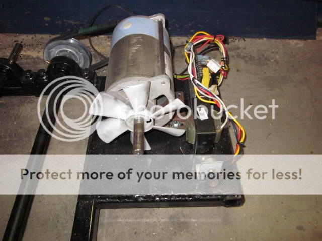

All I did was mount the treadmill motor and associated controller on the new frame. I left off the rollers on each end because with adjustable legs I could perfectly balance the base to keep the drum in the middle and not walk along the shaft.
Well I built 4 of them now for my friends over the weekend and every one of them asked me what parts are needed to make the drum spin at the correct amount if you only have a single speed motor like out of a furnace or washer/dryer.

With an adjustable DC motor like on a treadmill then just buy any two pulley's that you need and you can adjust the speed of the motor to get what you want.

....i love the way you made up a mock set up before you started to hack up some steel...
