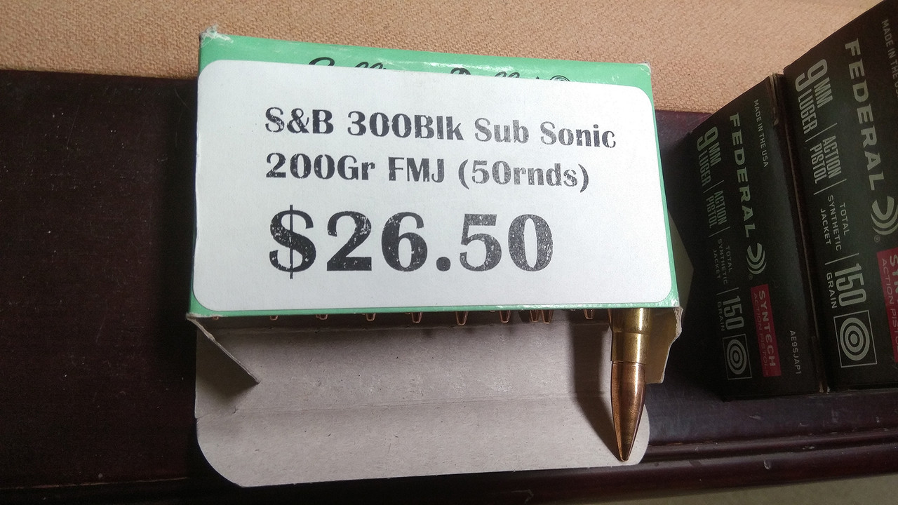

You ever try and run it on subsonics? If so how'd she do?
Thanks!
