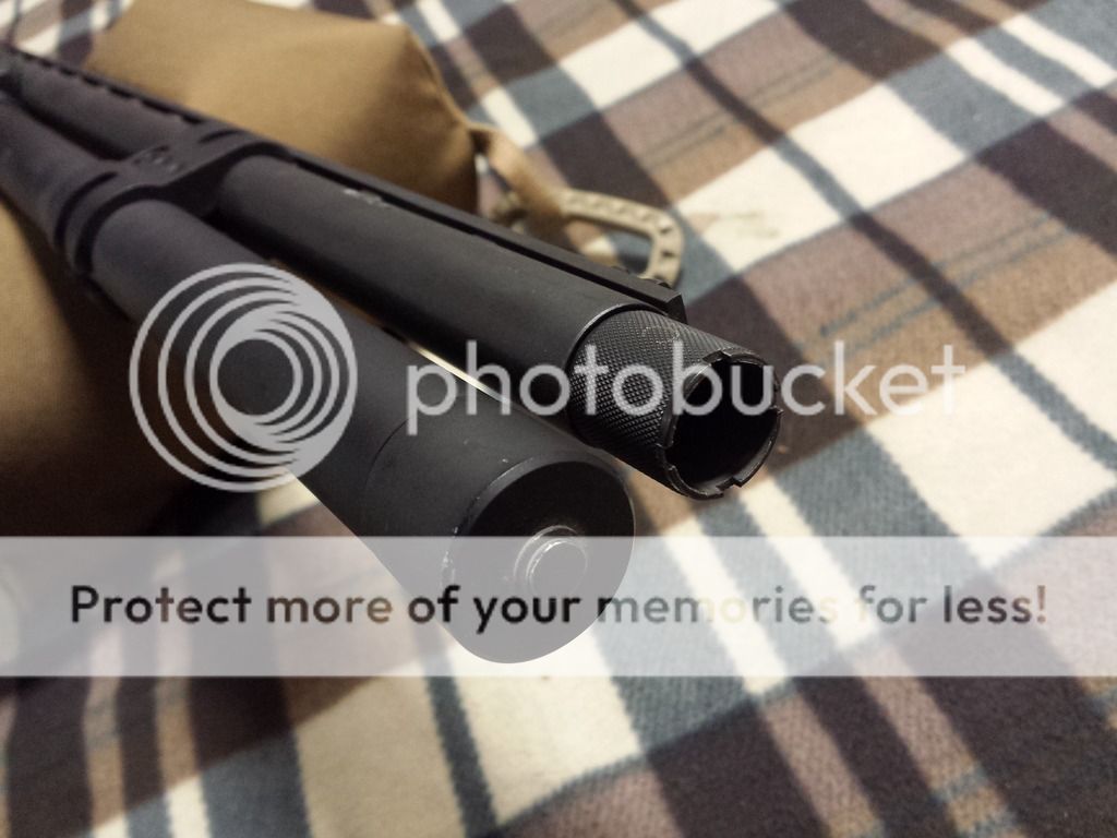

I bought a 3/8" aluminum rod from Can Tire, drilled and tapped through a Nordic cap then Bondo'd in place. I'll snap a couple pics when I get home.
Edit: snapped a couple pics. Also, since the plug has to be permanent, I ground the face off of the machine screw with my Dremel and touched everything up with the ol' flat black spray bomb. The "plug" has held up for 4 years of 3 gun, trap and lots of local tactical shotty nights! You can tell the gun has been used hard, lol
