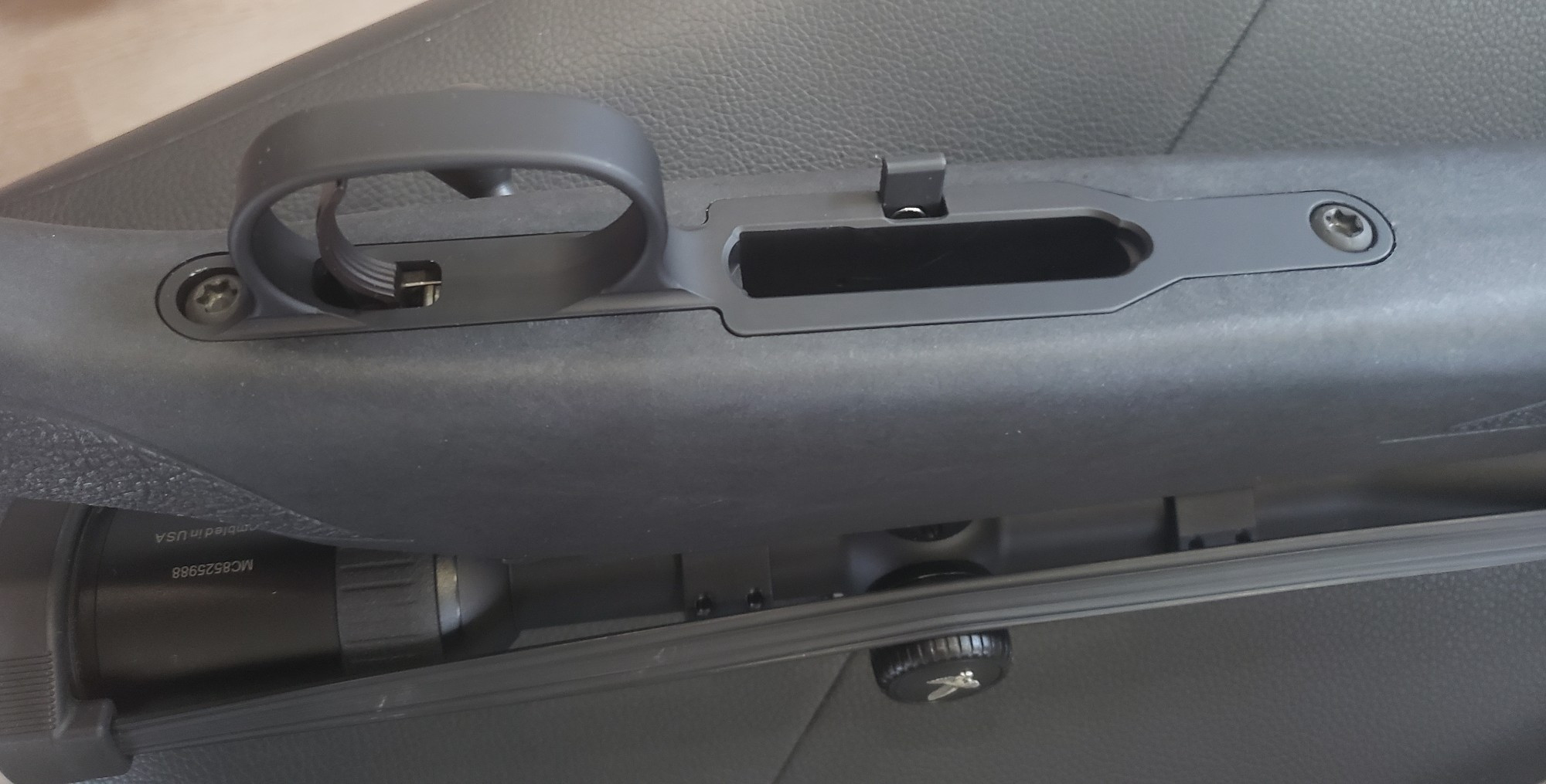

No magazines handy as I'm in between houses, but here's the bottom metal from jefferson's outdoors installed.
Shipped direct to me, they also make bottom metals for the regular mini magazines, as well as an blind floor plate.
I have a cz 527 carbine, so sharing magazines is alright by me.

Should be doing some testing in the next week or two.

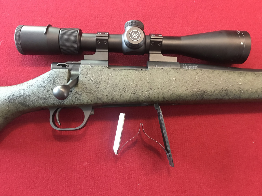

Where I learned about the cz 527 bottom metal for the howa
Not really worth watching as it has no rifle details, but the description says this rifle also has the cz bottom metal
That looks great! I like! I went with the Oregon Gunsmithing bottom metal on my 6.5 Grendel. Seems to work good and is light weight!

I replaced it a couple weeks ago with a CZ527.
I finally put a few rounds out of the rifle, unfortunately the scope ran out of adjustment to be properly sighted in.
The 527 fed smoothly and without issue though. Only a few rounds but the outlooks seems good for the setup.
