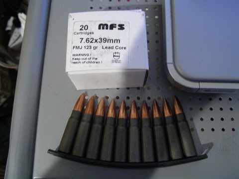

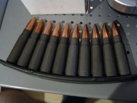

Is this the Stuff?
The Casings are more of a dark silver grey instead of a dark brown.
the Guy who sold it to me said it was "Mildly Corrosive" or "Half Corrosive" Whatever that means. I haven't fired any yet I have some Norinco ammo left but want to save it.
It's very corrosive(make that VERY VERY VERY, like the worst ive ever seen, corrosive). Left it a week and still no rust? What did you shoot it in, a Norc SKS? The Barrels on these are chromed(wont rust) but the gas system is plain steel and will rust solid...Hope your gun still works!

Tango2 said:
Is this the Stuff?
Tango2, it looks just like your photos...but no stipper clips. The box looks the same as well.
Half corrosive???? ....ok? So the Czec stuff is more corrosive?? Hmmmmmm?
sw
Yeah the Stripper Clip is my own. I have it ready to go for Cyote defence, I was just too lazy to open the box and take a few out for the photo op. I only own one stripper clip anyhoo, will have more I guess when I order a crate of Ammo sometime in the future.
