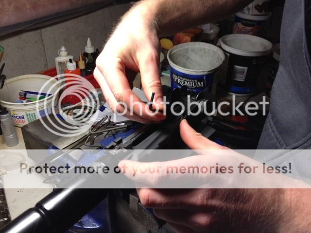

The hardest part about this installation is knocking out the stripper clip guide block... just ask Buzzballer. It took several blows with a block of wood and a steel hammer, but we got it off without skinning any knuckles or harming any animals. :D
Then we got to work:
I do have to mention that front pad screw... look at the bottom of the picture and locate the front pad screw, you will see the bent circlip hanging in the air. I'm new to this mount and I dunno if that bent circlip is a critical or important issue at this point. We still need to do some testing. Okay, back to the install process. :cool:
The clip guide anchor fit inside the Norc clip guide bridge perfectly, slight tapping with the plastic hammer was in order.
The side bolt needed a 3/8" box wrench (hey....that's the size of your gas plug or combo tool wrench :D )
Then we snugged down the rear allen screw, and alternated between the side bolt and that clip guide allen screw.
Now that front pad screw was a little on the goofy side. For under $ 100 , this scope mount had to have a weakness or two and I found out why this ProMag mount is half the cost of the ARMS18... :cool:
It's because one of the circlips around the pad screw was made of inexpensive and soft copper (metal) and it just self destructed. No worries because I did not think that this was a critical area or concern. Some of you experts with the ProMag can feel free to enlighten me. :D
