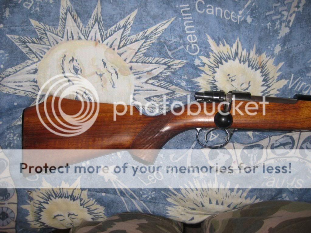

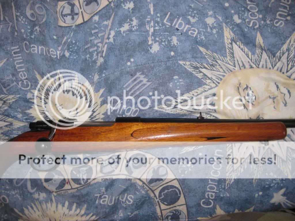

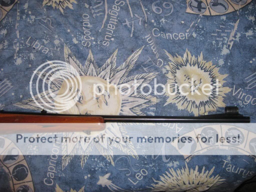

That's my husqvarna 1600 in 6.5x55 from trade ex. It was described as very good bore, very good condition and that was no lie, after alittle cleaning it looks, feels, and functions like a much more expensive rifle. That action is an improved mauser with the full length claw extractor and 3 locking lugs. The trigger is very nice, no creep, crisp let go, and IMO perfect for a hunting rifle, if your a target shooter you'll probably find it heavy because it's not 1.5-2.5lb. I believe a replacement could be fitted, but somebody with more info should be along to answer that for sure. Accuracy is very good imo, i'm no bench rest shooter and with factory federal ammo and iron sights 4shot grps 1.5" at 100y is the norm for my rifle. With handloads,scope and somebody who can shoot i'm sure these rifles will easily be sub moa. They're used, but the fit, quality and finish is still top notch, just check out my pics above.
