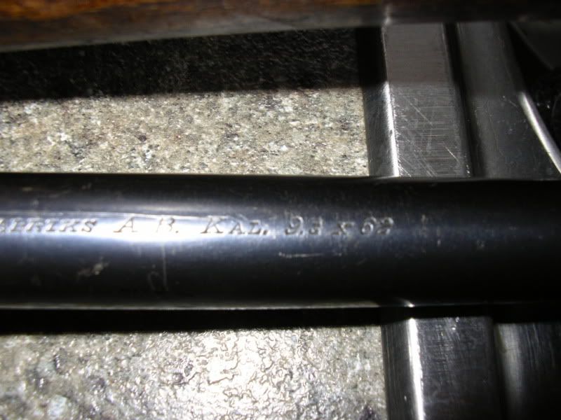

Not a rechambered '57, the rifle has the entire caliber designation roll stamped on the barrel, the same as my other one with the smooth contour barrel.

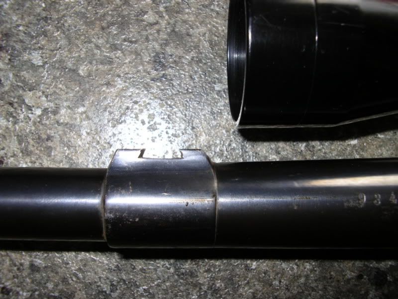

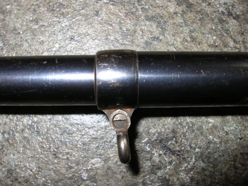

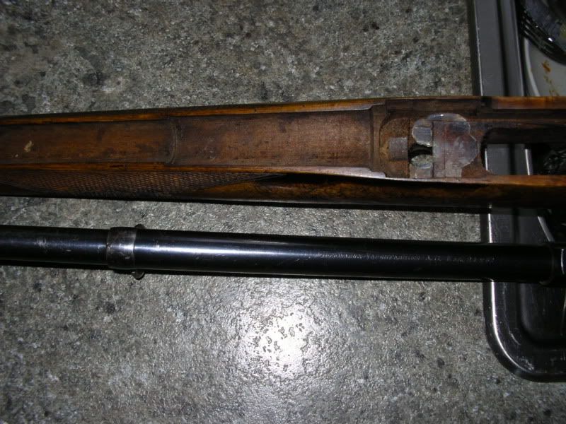

Just took a couple of pictures of the rifle to show the barrel and the inletting.
And, here's the roll stamp.
The rifle is wonderfully balanced with its 600mm barrel, and rather heavy beech stock.
Ted
Hi Ted,
It looks like a correct early 649 (M/98). The stock looks like the "beavertail" forend and if so, it's the correct one too.
As for the step barrel, do you mean in font of the chamber? Can you post pics of that area?
The step ahead of the chamber. Five digit serial number begins 934--
And beyond the forend, with the barrel band.
Have you ever seen this on a 98 action? I have seen lots of them on 96s, but never on a 98. Not suggesting the rifle is anything special, just curious.
Ted

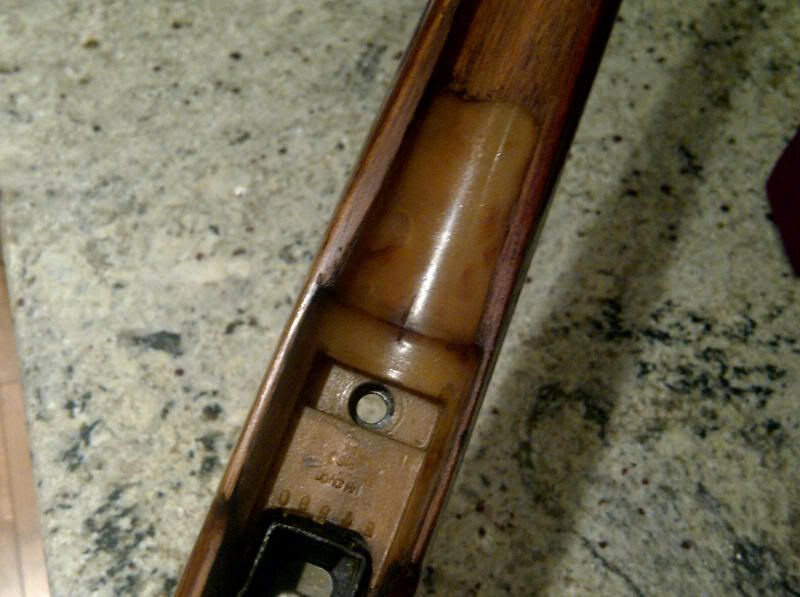

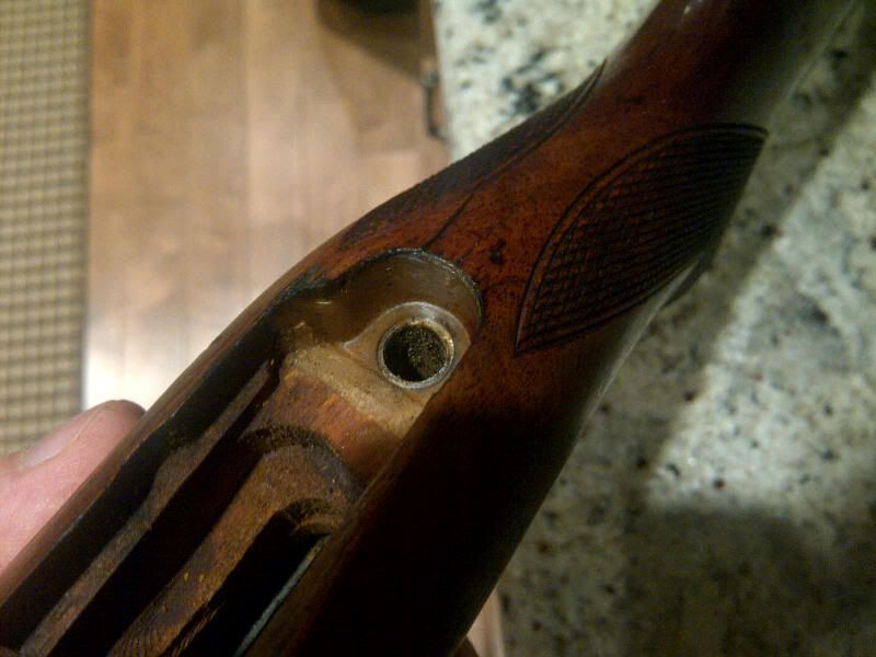

I just picked up a rifle from TradeEx. It's a 30-06 in the 1600 Lightweight [slimmer barrel, shorter barrel, and trim, light stock].
Now, I know that TradeEx has the reputation among CGN'ers of OVERSTATING issues, blemishes, etc, so that the rifles are usually in better condition than you think they are from reading the website descriptions, but in this case they UNDERSTATED the issue [the second rifle I got from them that was significantly UNDERSTATED with regards to issues].

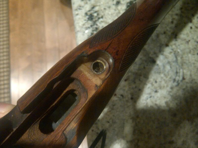

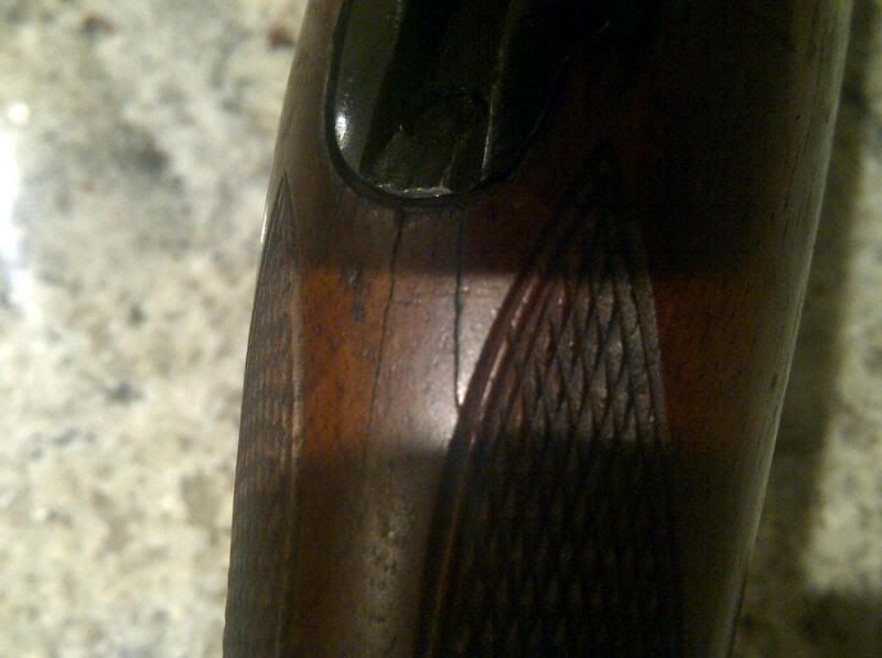

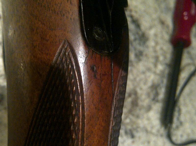

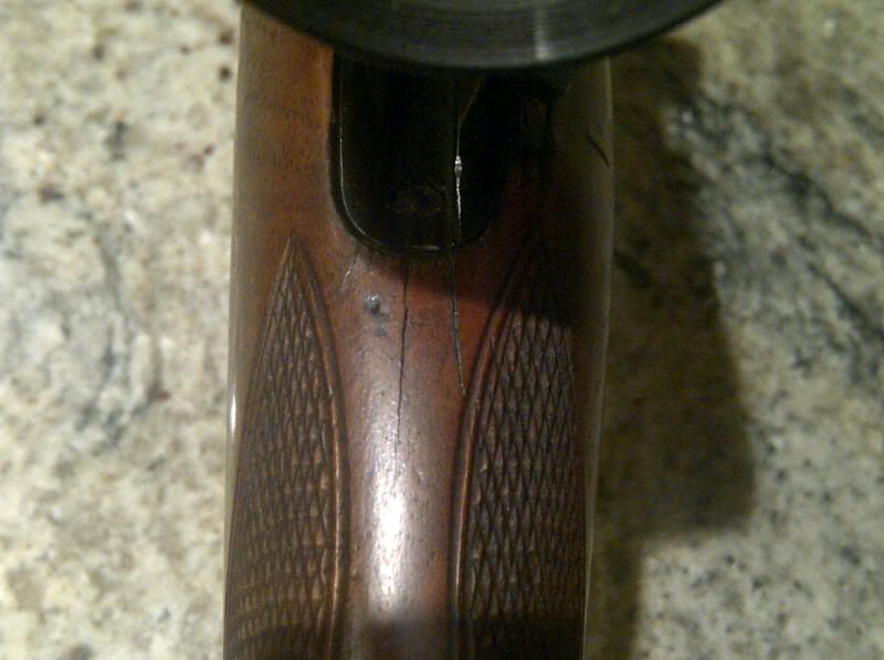

The description said a hair crack at the tang. Well, there are 3 cracks. One I would call a hair crack, and the other two could be called hair cracks... if the hair was from a large horse's maine.
No wood gaps, but significant and obvious cracking. Each crack is about 1" long looking with the naked eye.

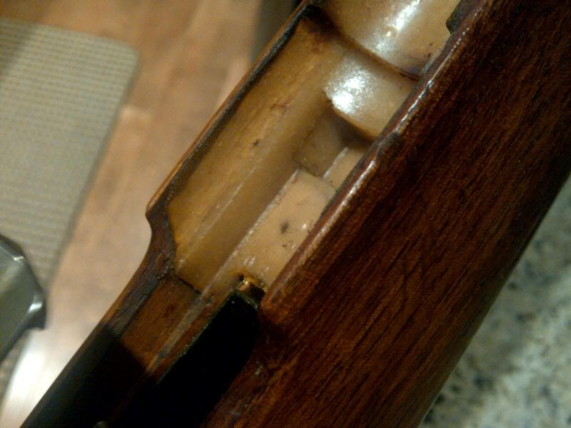

The rifle has been bedded with what looks like acraglass, at the recoil lug and at the tang. There are no cross bolt or pins in the stock.
So here's the question: Do you think the acraglass bedding will keep the stock together? Or does it need a cross-bolt or pin to keep it from breaking apart?
I'll try to post some pics of it tonight.
Well, hard to say without seeing it, but usually Trade Ex will provide you with plenty of pictures (almost at will, should I say - obviously, they're more patient than I am!).
I have absolutely no idea why or how the rifle was not described as it is / was, but to their defense, I must say they have so many rifles to clean and describe, they may have made an error, like most of us can do.
My personal advise is such, and I don't mean to judge or make a moral out of it; One should always inspect arriving shiprment and inform the shipper of any non conformity or damges / breakage of the received good, even if it's to be kept. Acting in such way will protect both the shipper and receiver. I, myself always take pictures of any shipment I am doing.
Anyhow, they're are ways to fix the "Mauser tang cracks", but it's a case-by-case matter, so just post your pics and I'll try to help.
