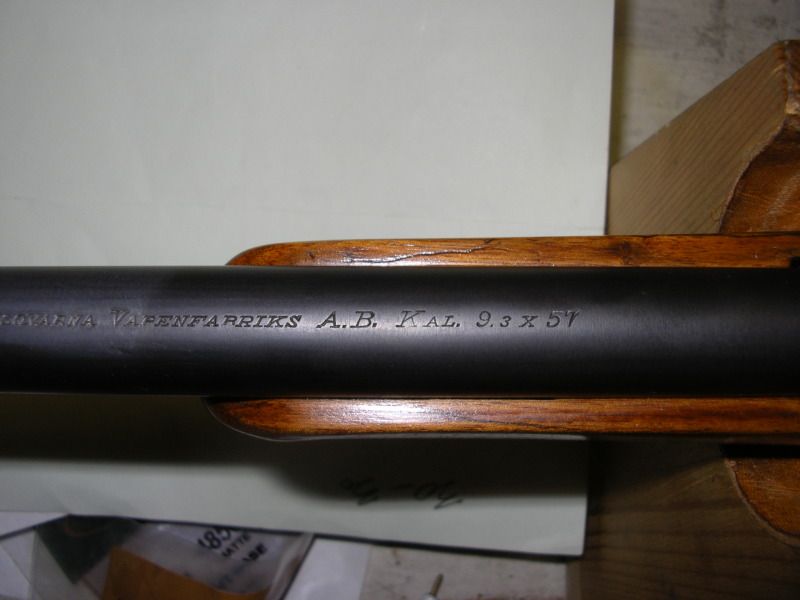

While generally the case, not all rifles in 9.3X57 are roll-stamped with just 9.3 to designate that caliber. Here's the rarely-seen complete calibre designation.
Anyone care to guess or determine the model? The world of Husqvarna firearms is varied indeed. :D
Ted
Some are stamped like this. I don't have access to my datas right now, but if I recall, from the top of my head, they are M/46A S/N above 175 000... is this right?
Well, my wrong, actually, I was at work and wrote the wrong S/N serie; should have read "above 40200"... I shouldn't write numbers without checking. The S/N sequence I gave was for the Shotguns of the same post 1942 period. It was a bit confused in my head that day ... :redface:
Anyways, what I wanted to say is that's it's a late M/46A. At that time, they had started up making the 46AN and they had to specify which 9.3 it was.
Yours even have the sleeved chamber / sight base / ring of the M/640.
The late 46A early 640's are somewhat confusing, because the S/N sequence that supposed to be early 640's will carry the M/46A/B stock style and serrated chamber / sight base and many think they are 46B...
Anyways, the cut between 1943" M/46 and 1944's M/640 is not always very clear.. I personally consider the arrival of the beavertailed beech stocks as being the beginning of the 640s...

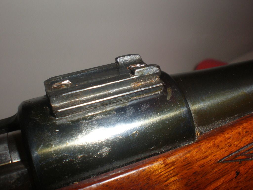

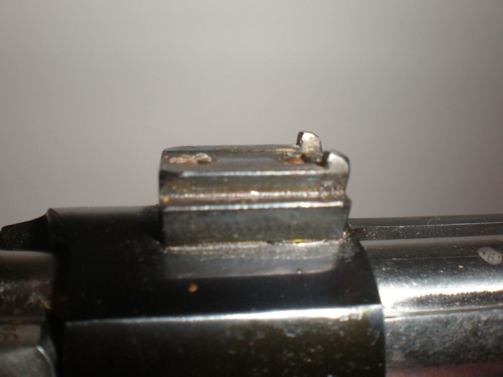

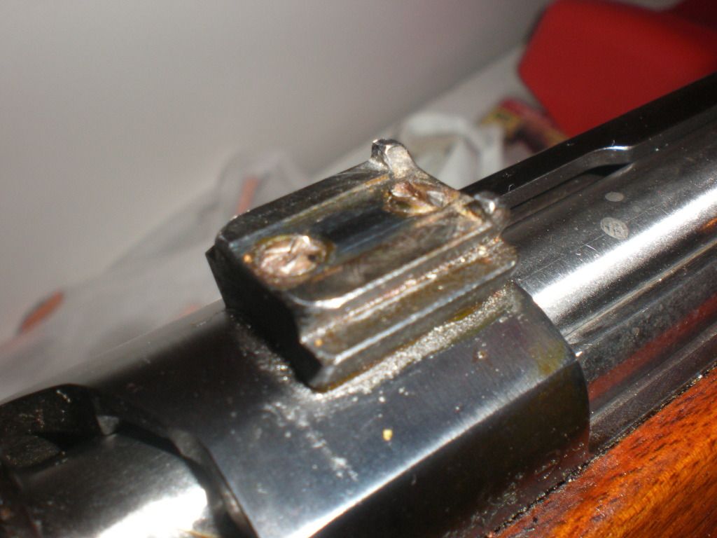

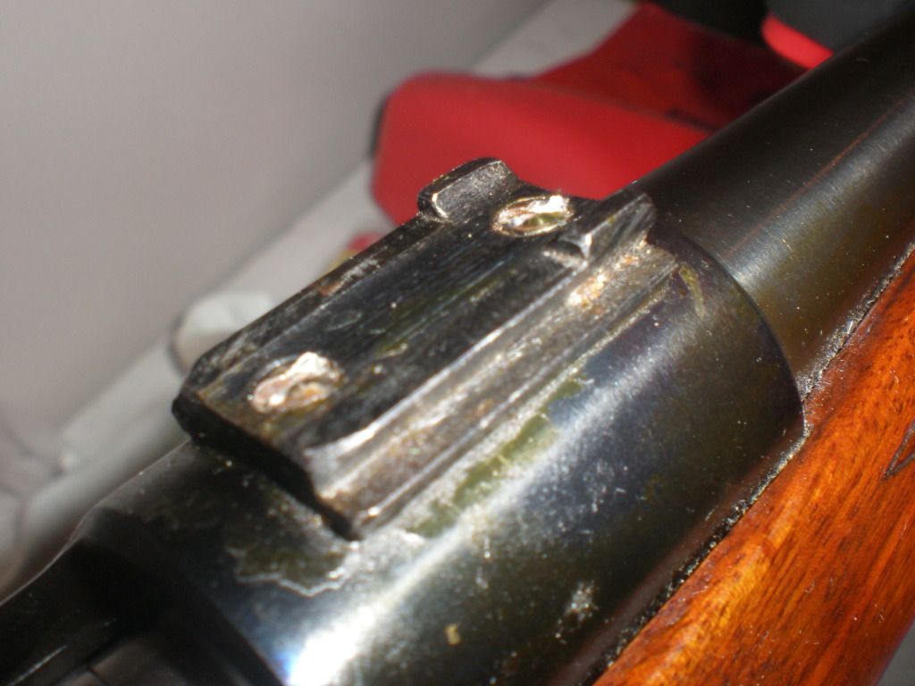

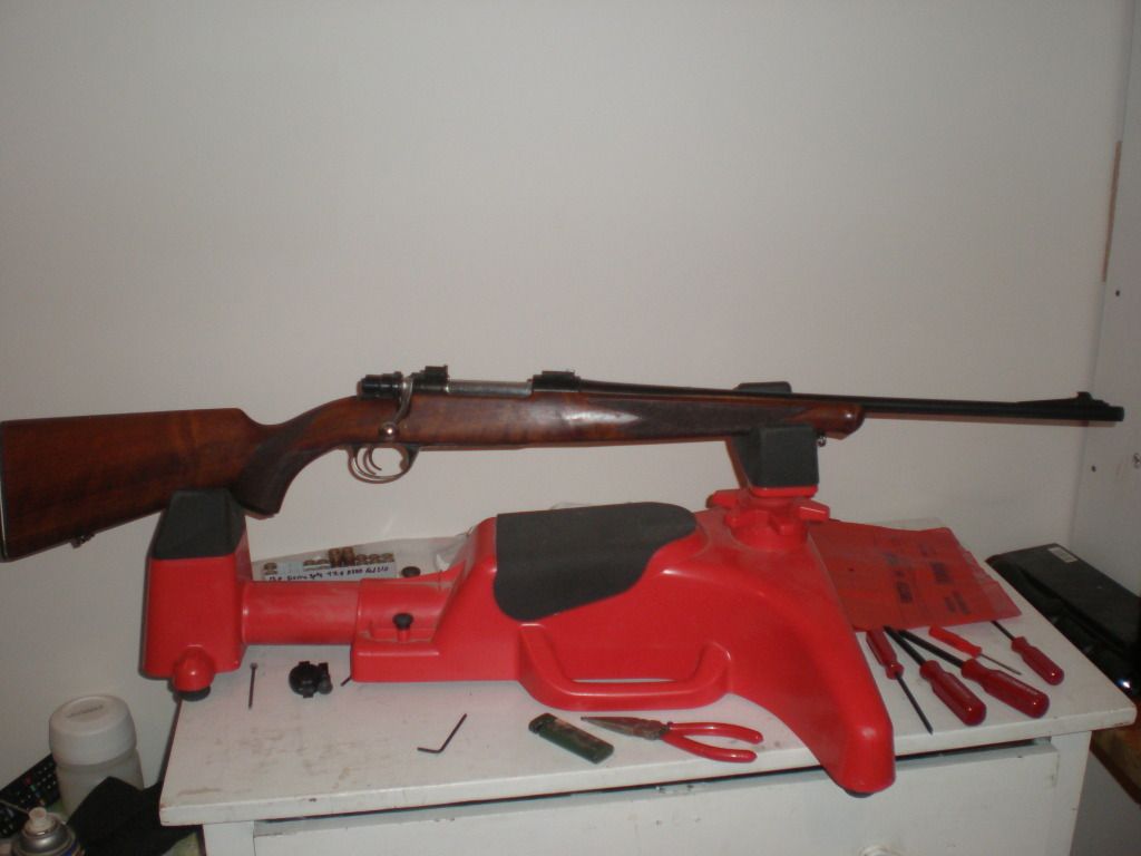

So I just acquired another Husky. A 4100 in 6.5x55. I just got it this evening, and it's really nice. Good wood, and even a nice trigger. It has some sort of European scope bases and I was just planning to remove them. Well, that didn't happen. I was just messing up the slot in the screws, and I even broke the tip on my screwdriver. I used some penetrant, and even a torch to heat things up, and no luck. I think these are on here to stay. So my question is, from the photos below, can anyone tell me what kind of rings I need, and where I could find them? I sure hope they'll work with a 1" scope.
It appears that those bases are soldered on.
If appropriate rings cannot be identified/found, you may have little choice but to drill the heads off the screws and melt the solder to remove the bases. Hopefully that solder has not bonded the screw shanks to the receiver threads.
I've had good results heating the solder to just barely melting point and scrubbing it off the blued steel with fine steel wool.
A fine rifle in a great chambering, worth whatever it takes to get up and running ... IMO.

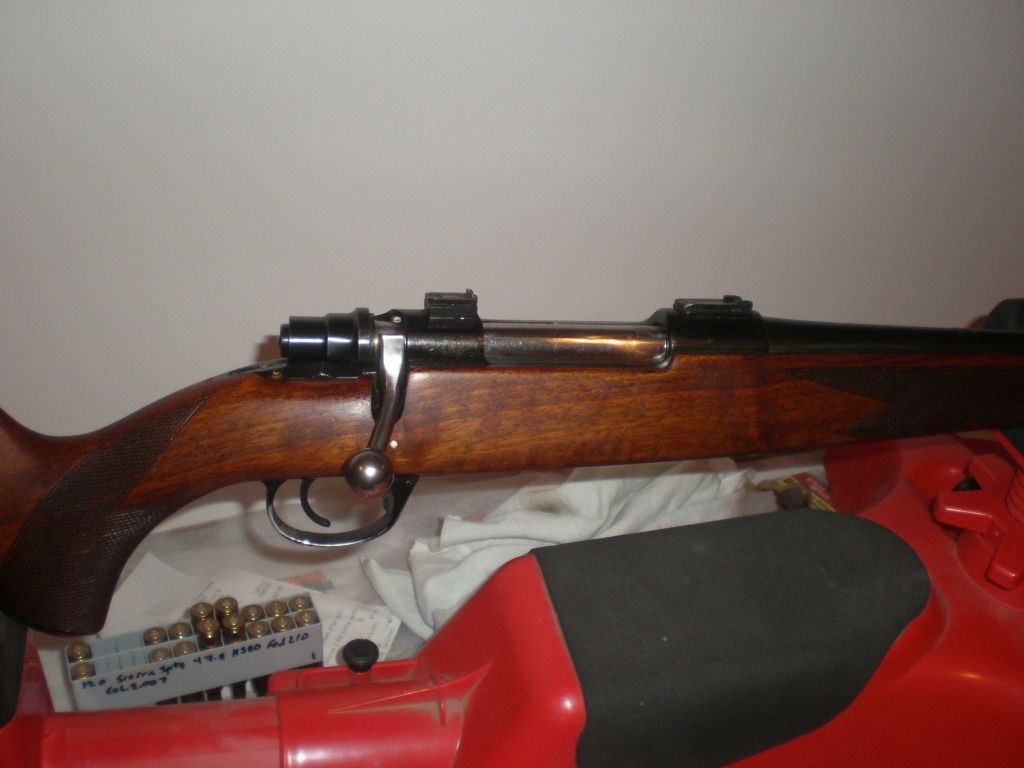

First Husqvarna, a 1600 in 6.5x55
Bought this little sweetheart at the beginning of October from trade Ex.
Husqvarna 1600 in 6.5x55 Swedish
According to the serial number (318###) date should be 1964.
Installed Weaver scope base # 46 on the front and a #55 on the rear and attached a Bushnell Banner I had sitting around, took it to the range today and it shoots a heck of a lot better than I can aim it.
