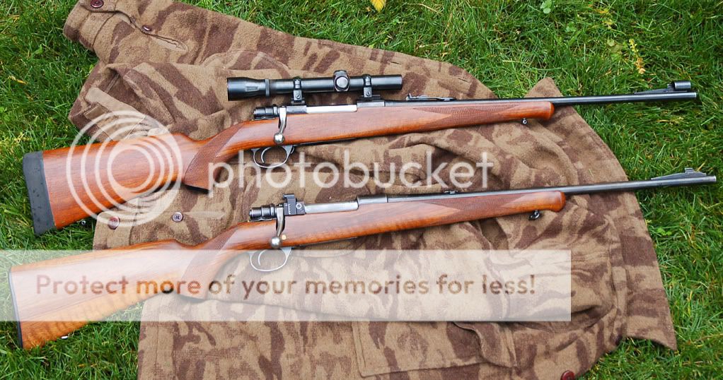

Trying again..... here is my 'new' 7x57 (top) and my .308. Both 4100's if I am not mistaken.... once I have finnished these two I will post a better picture...
Two beauties!
Just a note, watch that front sight hood is slipping off and will get lost in the next shooting session, learned that teh hard way with my first Hva.
