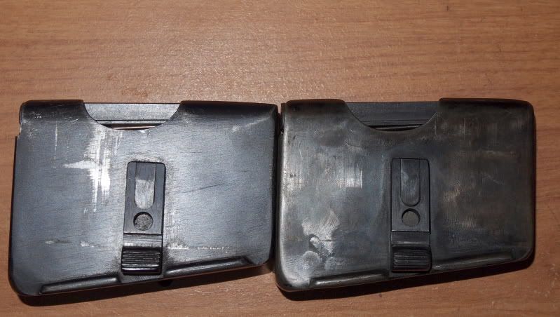

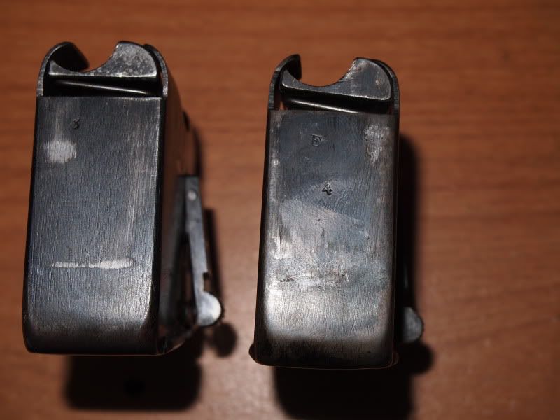

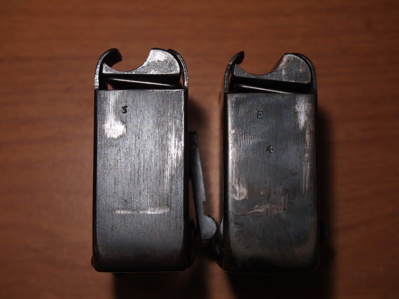

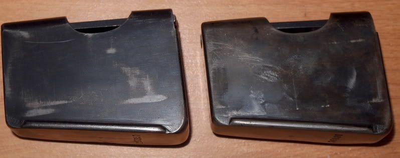

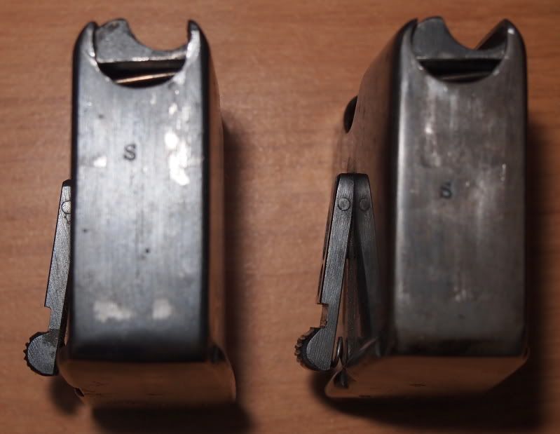

Might just be a question of in-letted the magazine cut out a bit. or as you mentioned the lips might have been forced out a bit preventing latch from closing. There is some variation on the in-letting as Swiss Products have found out on the 89,96/11,1911 and K11.
Some pictures of my 96/11 mag on left and K11 mag on right.
No major differences. Camera angle can play on perspective.
Compare to yours for lips and catch.
