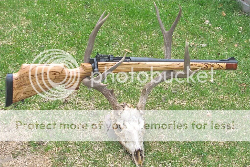

I just "bubba'd" an enfield, for bear defense!

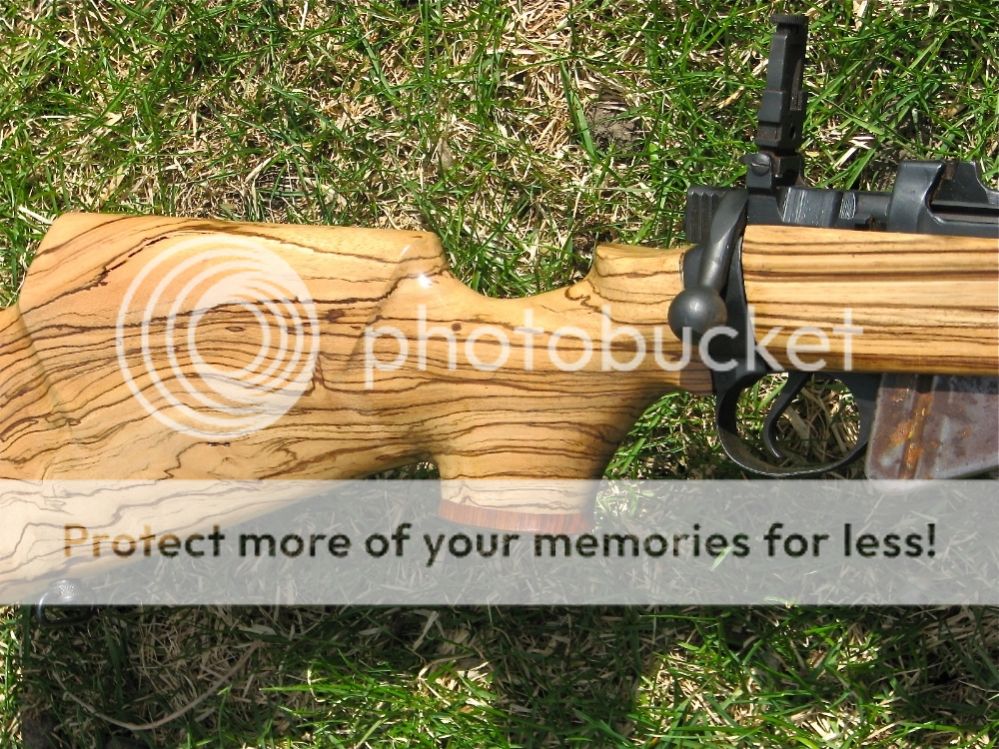

Nice wood and nice work, but what a waste of nice wood and work.
Butt (pun not intended, but I'll go with it anyways) - ugly IMO. Starts out well at the buttplate, but gets worse as you go along, ending at that red knob at the muzzle. Whew.
Does it kill bears though?
Looks good, where did you get the barrel and how hard was it to replace the original?
I have wanted to take on one of these 45/70 enfield builds for some time but just haven't taken the plunge.
I didnt do the barrel work myself, I had a smith do it. Though Im not very happy with his work and will need to have a few things worked out (i.e., front sight is off center and doesnt feed really well). Anyway it was fun to try stock making. I have no experience with that but I really enjoy looking at the grain in some pieces of lumber and might give it a try again one day.

So, I won't call that one a bubba, it's been nicely done. The butt-stock and pistol grip are a bit exaggerated to my eye, but that is subjective, and the workmanship is impressive no matter what. You did find a piece of wood with really nice grain and showed it off. If you were taking on work, I'd certainly not be reluctant to entrust something to you.
Any day that an already Bubba'd No4Mk1 L.E. becomes one's "go to" truck/bush gun ... Is A Good Day. IMO.
Please, keep us informed on that 45/70 conversion's problems and progress ..... always wanted to build me one.
You have done some very good work there cody c.

A very nice job and a great piece of wood.

The ##### tip is a bit distracting, if you removed it you would get to see that fat barrel as well! Very cool project though, the 45/70 rounds load in the mag all right? I assume there's some mods in there as well?
Yes the mag was modified, basically it has two pieces of thin metal that narrow the space so the cartridges only stack on top of each other in a straight line.
Ive heard of someone who did the same conversion and had the magazine working without doing this, and gaining capacity that way. This setup will only take 5 rounds in the mag. I shouldnt need more than that, but I like the idea of being able to take 8 or 9 rounds in the original magazine.
Overall there is a lot of positive feedback, I appreciate it alot, Thanks!
One thing about the "##### head" as its been called, I wanted to copy the look of the manlicher full stock rifles and had a difficult time following the lines from pics on the net. I think maybe I should have made that piece a bit shorter, but I cut it to match the position of the front site. I guess I didnt get it perfect. Maybe on the next one.
Your truck/bush gun is nicer then all my gun lol very good work!
Thanks, If you guys have an itch to try it for yourself, I probably spent $100 on wood at windsor plywood, and $30 on sandpaper. Had to buy a couple chisels too which werent too expensive.
Any reason you chose to use a No5 or "Jungle Carbine" action? The No.4 is stronger.
I have to honestly say that the design is not my taste, at all, but only you have to like it and the work involved in making something like that from a plank is vast, so you deserve full marks for skill and perseverance.
So... It's done and has a proper (NECG) front site and has been blued, also I changed the shape a bit, knocked a bit off the overall length on the butt stock, a bit off the front from all the "looks like a ####" comments, and took some off the palm swell(?) as it was a bit much and I'm happier with it now, anyways, it's done and getting a few coats of varathane nano floor finish, just thought I'd update/finalize the thread:
