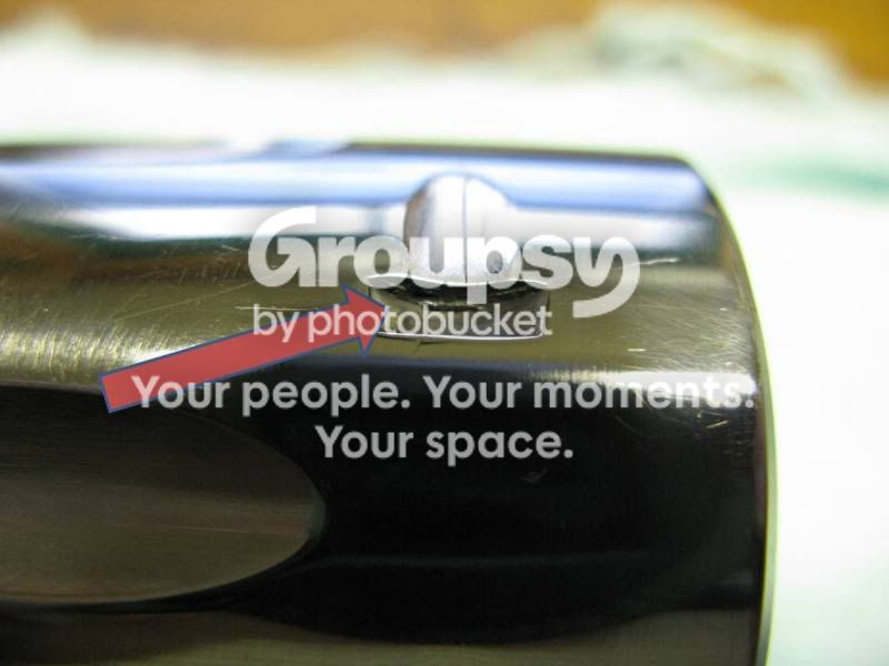

Everyone is entitled to their own opinions regarding whether or not a particular cartidge is safe or not. +P, +P+, margin of error, etc., well it sometimes comes down to a roll of the dice. Case in point, I had some 45 Colt cartridges with a nice light cowboy loading, lightly crimped as well as it turned out. Had a few, maybe 5 or 6, where the bullets were pushed into the case a bit more than normal. Could have easily impact drove them out but I thought that my nice strong Ruger could handle any extra pressure. Got two rounds off, didn't feel that bad, bit snappier than ususal that was all. Next one split the chamber and turned that nice Ruger into a five-shooter for sure.
As I said, it is your call whether or not you use cartridges that are out-of-spec or not. Just don't whine about it when the inevitable catches up with you.
