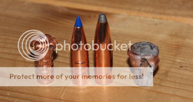

I lost two bears in three days while shooting 185gr TTSX out of a .338 WM. Easy shots on broadside animals with a rock solid rest and lots of time. Guaranteed they were hit - no blood, no hair and no bears. Searched for each one for hours. I was worried that I lost zero so I went to the range. The rifle was spot on. I shot one into a round of spruce at 200m (220 yards) and then a round with a 250gr Partitions This is what I recovered:
Note the 250gr Partition opened really nicely
Yes, a round of spruce is not a bear etc etc. I'm curious how much that TTSX opened up on soft bear lungs. Given the results of the hunt, I suspect it was very similar to what Eagleye and Chuck Nelson posted.
