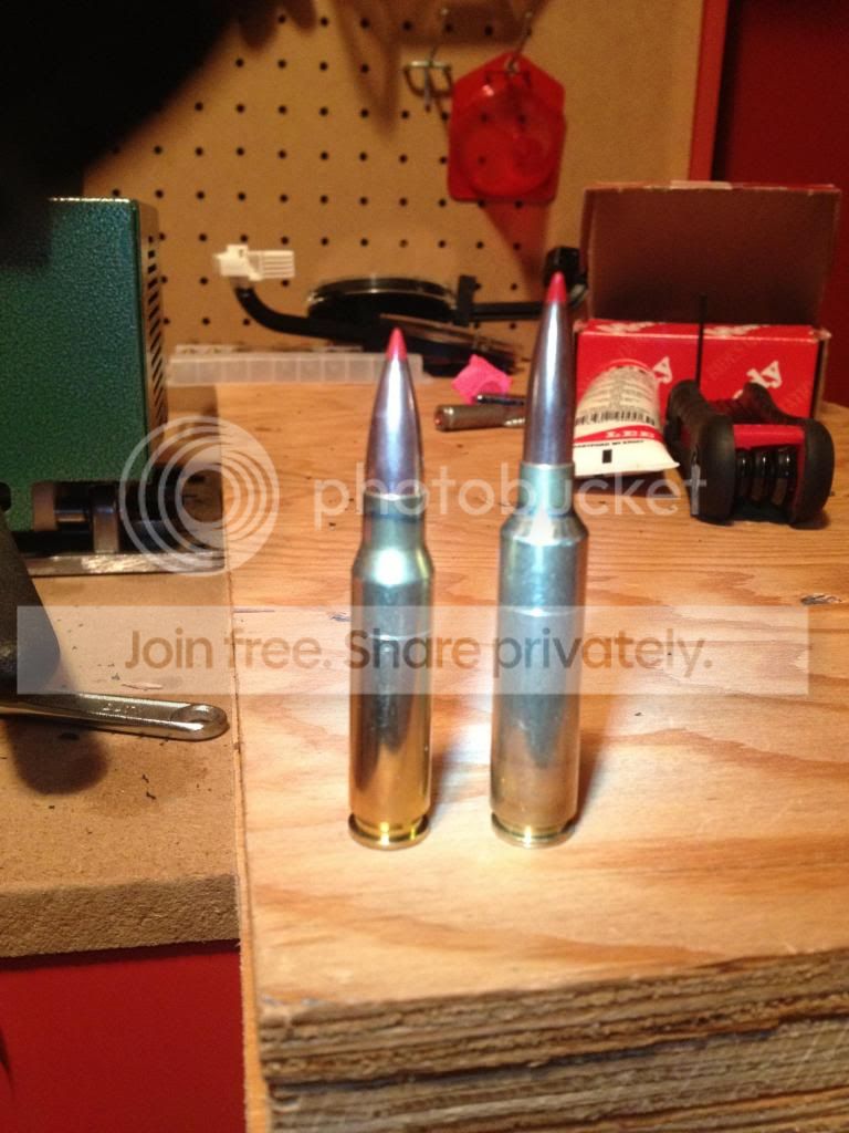

Hi,
I am relatively new to reloading, I have done the process a bit and had a great instructor who really knew what he was doing, the problem is its been a while since I have done any reloading at all and now, I have ran into a snag. I am getting a ring around the cases when using my sizing dies. One is a FL .308 RCBS die, the other a 6.5x284 Forrest neck sizing die. I am not sure what I am doing wrong here, at first I thought it was something in the die of the 308, like an unfinished edge or something..... but then I tried the 6.5 die, and the same ring is appearing. You can feel this line with your fingernail, its is a very light score. The 308 had some tightness coming out of the die (more than I think there should be), the 6.5 had barely any resistance at all, I am a little baffled at this and any help would be greatly appreciated.
