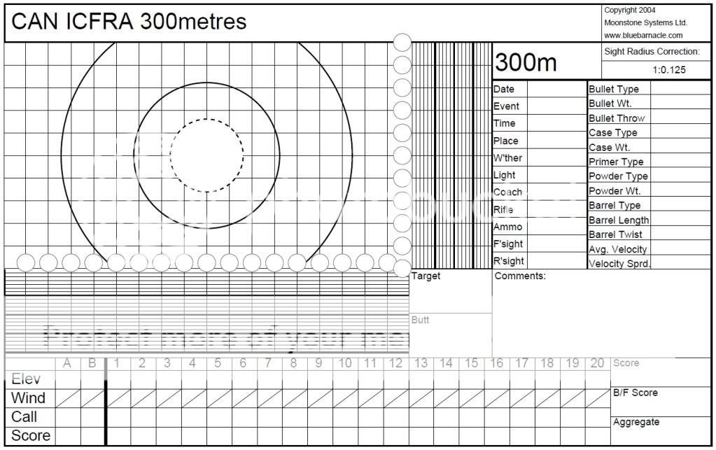

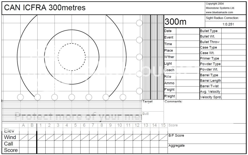

I have drawn most of the DCRA and ICFRA plot sheets. MOA is MOA and you can transfer one to another with a pencil to give a quick comparison. I can give anyone pdfs of these if asked.
I have a set of the ICFRA dimension plot sheets (for F-Class) including 1/4 min hash lines.
Mine are closeups of the target centers rather than full target faces.
Here is an example, they print 2 to a page but this is one of the plots.
EDIT: This is 1/8min hash marks
Here is the 1/4 min version
Can be downloaded below, you will have to register to retrieve.
300-900m w/ score for 2 sighters and 15 rounds.
